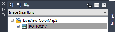

If the Image Manager toolspace is not open, click Raster menuManage.
In Image Manager, select the Image Insertions view.
3
In the Image Insertions view, right-click the image name and click Edit Color Map.
