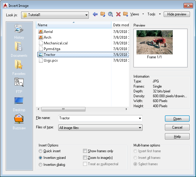

When you click Raster menu
Insert (or enter iInsert on the command line), the Insert Image dialog box is displayed. Here you can preview the image and information such as file type, color depth, and density. The column of folders along the left side of the Insert Image dialog box is called the Places List. It contains shortcuts to local folders, such as your Favorites folder or My Documents folder.
