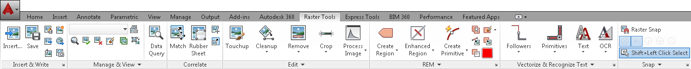

Ribbon
The ribbon that is displayed for most program workspaces includes a Raster Tools tab, which contains many of the commands that you use for AutoCAD Raster Design toolset. Click the arrows below each panel to access additional commands.

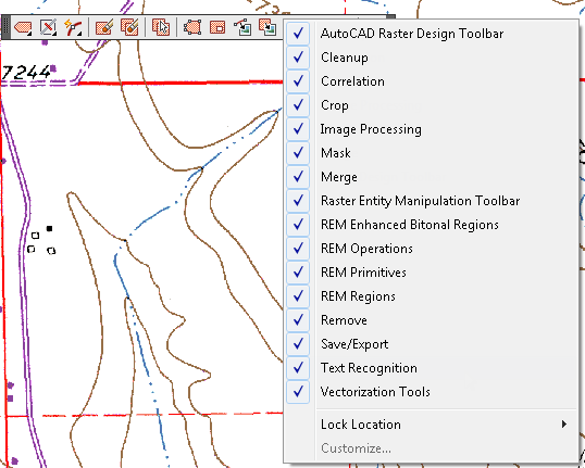

To display the menu of available toolbars, right-click an open AutoCAD toolbar. You can open any other toolbar from the shortcut menu.
Menu of toolbars
