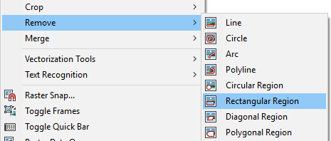

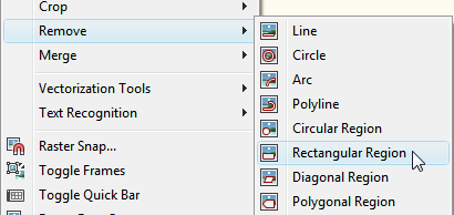

Click Raster menuRemoveRectangular Region.
Click and draw a rectangle around the Mandrel Rib Plate and its title block, right-click, then click Enter to rub the region.
Further exploration: Rub other objects, except the Jig Bracket in the lower left corner. Use some of the other region types on the Remove menu to do this.
