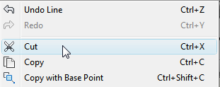

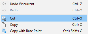

Select the border of the REM region, right-click and click Cut.
The window outline is deleted, leaving a red X to mark its bottom left corner.

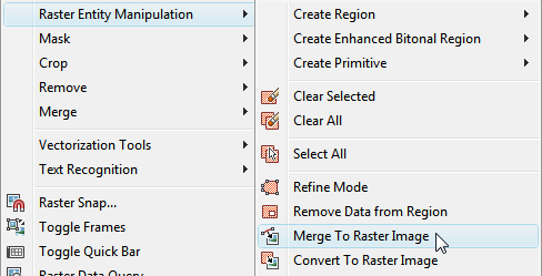

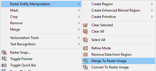

Click the REM window, then click Raster menuRaster Entity ManipulationMerge To Raster Image.
REM window 1 is converted to raster.
