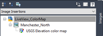

If the Image Manager toolspace is not open, click Raster menuManage.
In Image Manager, select the Image Insertions view.
3
In the Image Insertions view, right-click the image name and click Edit Color Map.

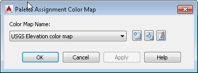

In the Palette Assignment Color Map dialog box, click to edit the color map.

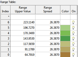

In the Palette Color Map Definition dialog box, in the Range Table, note that each color on the map represents an elevation range of 86.57 m.

In the Palette Assignment Color Map dialog box, select the Slope color map, then click Apply.

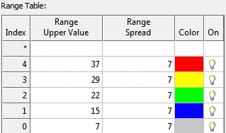

7 Click to see the Range Table for this color map. Note that each color represents a slope range of 7 degrees.
