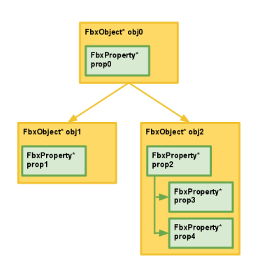

Connections can be visualized as a destination and source hierarchy of FBX objects and properties.
FbxObject::GetSrcProperty() will return the object's source property at the given index. Symmetrically, calling FbxProperty::GetDstObject() will return the property's destination object.FbxObject::GetSrcObject(). An object's parent is a destination, and is accessed using FbxObject::GetDstObject().FbxIOSettings). Typically, a property's children are sources, and are accessed using FbxProperty::GetSrcProperty(). A property's parent is referred to as a destination, and is accessed using FbxProperty::GetDstProperty().
Accessing the source objects of obj0:
// ... Assume obj0 has been initialized to reflect the diagram above...
// For illustrative purposes, count the number of source objects connected to obj0.
int numSrcObjects = obj0->GetSrcObjectCount(); // numSrcObjects = 2
// Access the two source objects connected to obj0
// Note that obj0->GetSrcObject(0) is equivalent to calling obj0->GetSrcObject()
FbxObject* obj1 = obj0->GetSrcObject(0);
FbxObject* obj2 = obj0->GetSrcObject(1);Accessing the source property of obj0:
FbxProperty* prop0 = obj0->GetSrcProperty();Accessing the destination object of obj1:
// ... assume obj1 has been initialized to reflect the diagram above...
FbxObject* obj0 = obj1->GetDstObject();Traversing the hierarchy in an ad-hoc manner starting from obj2:
// ... Assume obj2 has been initialized to reflect the diagram above...
// Access prop2 using obj2.
FbxProperty* prop2 = obj2->GetSrcProperty();
// For illustrative purposes, count the number of source properties of prop2.
int numSrcProperties = prop2->GetSrcPropertyCount(); // numSrcProperties = 2
// Access prop3 and prop4, which are sources with respect to prop2,
// respectively indexed at 0 and 1.
FbxProperty* prop3 = prop2->GetSrcProperty(0);
FbxProperty* prop4 = prop2->GetSrcProperty(1);
// Access obj0 using obj2.
FbxObject* obj0 = obj2->GetDstObject();
// Access prop0 using obj0.
// Access obj1 using obj0.
// Here, we assume obj1 is indexed at 0, whereas obj2 is indexed at 1.
// Access prop1 using obj1.
FbxProperty* prop1 = obj1->GetSrcProperty();The concept of connections in the FBX SDK allows for instances of FbxProperty to be dynamically added to a FbxObject. This gives you the flexibility of defining your own datatype, wrapping it into an FBX property via the FbxProperty::SetUserDataPtr() member function , and binding that property to an FBX object via the FbxObject::ConnectSrcProperty() member function.
