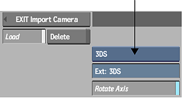

To import a 3ds Max camera:
The Import Camera file browser appears.
You return to Action and the imported camera is applied to your scene.

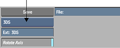

To export a camera to 3ds Max format:
The Export Camera file browser appears.
