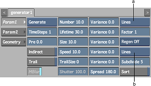

The following Generator properties affect the rendering and previewing of the particle stream.
(a) Interactive Type box (b) Render Type box
For example, if you generate 1000 particles with manipulators and bouncers, interacting with Action may become slow because calculations have to be made for each particle. If you specify a factor of 10, the number of particles is reduced to 10%, or 100 particles. Using Action is then faster, yet when you click Preview or Process, 1000 particles are created.
