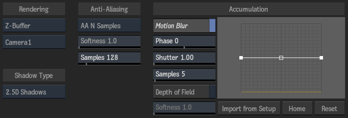

Rendering Settings
- Z-Buffer Mode box
- Select an option to determine whether the distance from the camera eye is considered.
| Select:
To:
| Z-Buffer
Arrange sources according to their distance from the camera eye.
| Z-Buffer Off
Not consider the distance from the camera eye when arranging sources.
| Shadow Mix
To render each shadow in the correct Z order with its corresponding source.
- Camera Selector box
- Select the child camera under a parent source node.
Shadow Type Settings
- Source Shadow Type box
- Select the type of shadow cast for the source node.
This setting is available in the Shadow Cast menu only if the shadow cast node is a child of a source node, and is repeated in the Source menu.
Anti-Aliasing Settings
- Anti-Aliasing Sample box
- Select a software anti-aliasing sampling level. To set an arbitrary amount of animatable samples, select AA N Samples, then choose the number of samples in the Samples field that appears.
- Softness field
- Displays the softness of the anti-aliasing sample. Editable.
- Samples field
- Available when AA N Samples is selected in the Anti-Aliasing Sample box. Displays the number of anti-aliasing samples to consider. Editable and animatable.
Accumulation Settings
- Motion Blur button
- Enable to use a motion blur effect for the selected source node (can only be used if the global Motion Blur is enabled in the Action Setup menu).
- Phase field
- Displays the frame that motion blur is based on (before or after the current frame). Editable.
- Shutter field
- Displays the duration of motion blur at each frame. Editable.
- Samples field
- Displays the quality level of motion blur and the depth of field produced by the number of samples taken at each frame. Editable.
Increasing the number of samples causes the processing time to increase linearly. The number of motion blur samples is multiplied by the number of anti-aliasing samples. To reduce the total number of passes made for each frame, reduce the level of anti-aliasing when Motion Blur is enabled.
Tip: You can animate the Motion Blur button, as well as the Phase, Shutter, and Samples fields in the Channel Editor under the
source > motion_blur folder.
- Depth of Field button
- Enable to use the camera's depth of field.
- Softness field
- Displays the softness of the depth of field. A low value yields a sharp falloff between focused and unfocused regions. Editable
- Motion Blur Curve
- Displays the sample weight over the scope of the motion blur.
- Import from Setup button
- Click to use the anti-aliasing and motion blur values from the Setup menu.
- Home button
- Resets the curve viewer to show the whole curve.
- Reset button
- Resets the anti-aliasing and motion blur settings to their default values.
