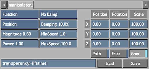

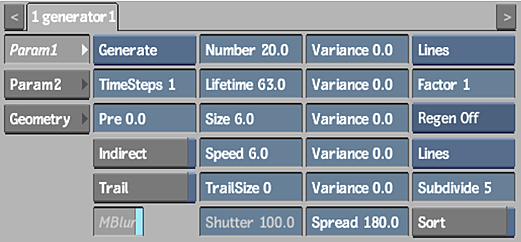

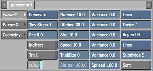

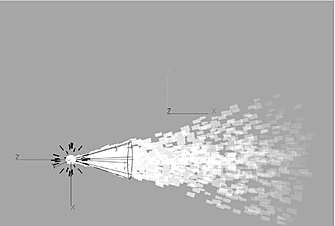

The following example illustrates how to make particles become transparent as they reach the end of their lifetime using the expression transparency = lifetimeI. The settings in the Particle Manipulator menu, Particle Generator menu, and the resulting effect are shown.

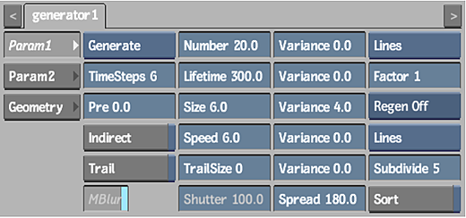

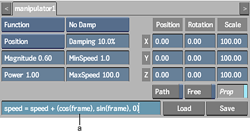

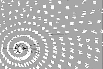

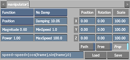

The following example illustrates how to spin particles using the expression:
The settings in the Particle Manipulator menu, Particle Generator menu, and the resulting effect are shown. Notice that the particle Timestep value is increased to improve the accuracy of the particle stream.

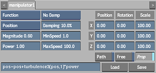

The following example illustrates how to create animated turbulence using the expression:
