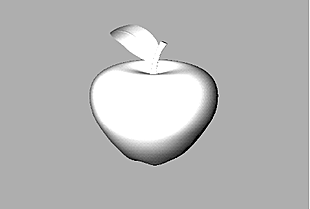

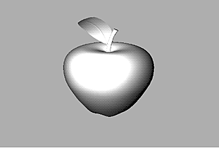

A high Shine value produces a dimmer highlight while a low Shine value produces an intense highlight. When the Shine field is set to zero, the 3D model does not have a highlight. The following example shows the same 3D model using two different Shine values.
![]() Shine is set to 1. The specular highlight is intense. |
![]() Shine is set to 20. The specular highlight is dimmer. |
