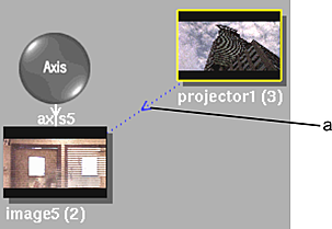

In the schematic, the projector is displayed much like an image. By default, it projects an image across the entire scene.
Once a selective connection is created, the projector only affects the object to which it is connected.
(a) Inclusive projection connection
Once an exclusive connection is created, the projector ignores the node(s) to which it is connected.
(a) Exclusive projection link
