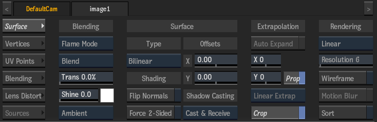

After you set the parent-to-child relationships between lights and surfaces, you can set specific surface lighting properties. You control a surface's lighting and adjust the surface's specular highlight in the Surface menu. To access the Surface menu, double-click the selected surface in the schematic, or follow the tab population rules for the Object menu (see Populating Menu Tabs of Selected Objects).
A specular highlight is a reflection of a light source. The position of the specular highlight depends on the position and number of light sources surrounding a surface and the angle of the camera.
Use the Shine field to change the intensity of the specular highlight. When the Shine value is set to 0, the specular highlight is disabled. To change the size of the specular highlight, use the Falloff field in the Light menu.

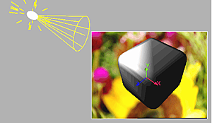

![]() This surface is lit using a Falloff of 30 and a Spread of 27. The surface's Shine is set to 10. |

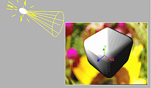

![]() This surface is lit using a Falloff of 20 and a Spread of 27. The surface's Shine is set to 1. |
