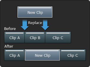

Replace Edit button
Click to replace the selected timeline clip or clips with the selected source clip. The overall length of the timeline sequence does not change. The replacement clip must be of equal length or longer than each clip it is replacing. If longer, extra frames are added as tail frames.

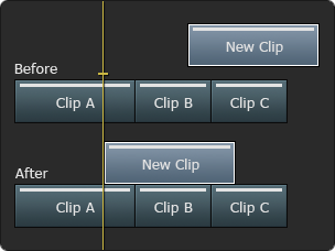

Aligned Edit An edit aligning a point on the timeline with a point on the source clip.

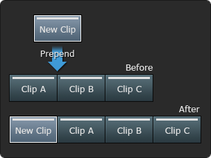

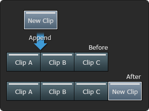

Append An insert edit that adds your source clip to the end of the edit sequence on the timeline.
Prepend An insert edit that adds your source clip to the beginning of the edit sequence on the timeline.

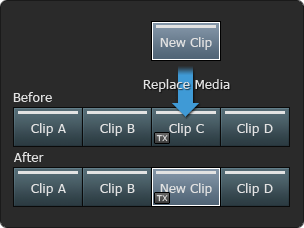

Replace Media A replace edit that retains any effects applied to the replaced clip or clips on the timeline.

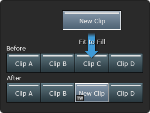

Fit To Fill A replace edit; but instead of adding tail frames to a longer source clip, a timewarp is added to the replacement clip so that it fits the same duration occupied by the clip it is replacing.

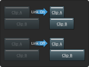

Link button
Enable to select and link all elements in an editorial group. This is useful if you want to trim all clips in a group by the same number of frames, for example. You can invert the Link mode on-the-fly during manipulation, with the Invert Group Selection keyboard shortcut.

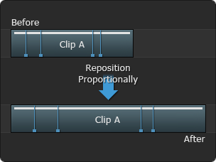

Reposition Proportionally Resize the channel as you trim. The animation channel is scaled to fit into the timeline element. This option has no effect when you slip or slide.

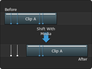

Shift With Media Link the keyframes to their original frame numbers. The animation channel moves to follow the original frames as you trim.

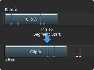

Pin To Segment Start Unlink the keyframes from their original frame number. The animation channel remains with the timeline element as you trim.
