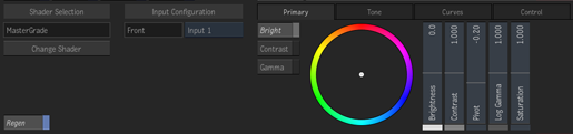

Using MasterGrade Primary and Tone Controls
When in the Primary and Tone controls, every mode has a set of vertical sliders on the right, and a set of tabs and colour wheel on the left.
The sliders:
- Show at a glance what the primary grade is doing.
- Can increase or decrease the control past the top or bottom of the slider.
- Are adjusted by clicking the slider and dragging the cursor left or right, in addition to up and down. This allows for a greater range of motion. The controls only respond to one type of motion: if you start to drag vertically the control will not respond to horizontal movements, and vice versa.
Important: Certain controls make use of both the slider as well as the colour wheel. In that case, the slider provides the
master, or neutral, adjustment while the colour wheel provides the
differential
RGB adjustment. The master sliders depend on the MasterGrade mode, but they are the ones that duplicate the colour wheel tabs.

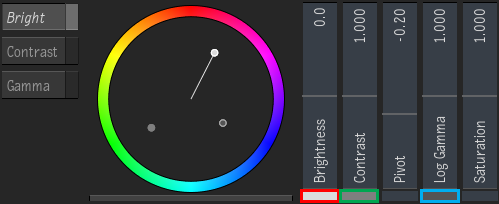

The colour wheel:
- Switch to the various controls using the tabs on the left.
- Display a line from the center to a dot, showing the current setting.
- Displays ghosts dots to show where the other controls are set. The coloured rectangle under the Master sliders define the colour for each control. The dots in the Colour Wheel match the corresponding Master control.
- Works similarly to the Look tool.
- Click & drag in the wheel to move the adjustment in the drag direction.
- Click and drag the dot of a previous adjustment to modify the strength of the adjustment without modifying the relative RGB ratios.
- Control+click in the colour wheel to reset the control.
- Can increase even after the dot has reached the edge of the wheel. In this case, the dot turns into an arrow to indicate that the adjustment lies outside the diameter of the wheel.
Because
Bright is the select control, the white line points to the dot marking the value of the colour wheel's Brightness control. The dot is white because the Brightness slider's box is white (highlighted in red on the left).
Then, you can see at glance the colour wheel values for Contrast and Gamma by matching their master slider's box (highlighted in green for Contrast and in blue for Gamma) to the dots in the colour wheel.
The gearing of both the colour wheel and the sliders is set to allow very precise adjustments. However,
Alt+Space+click speeds up the slider's response.

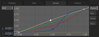

Curves
The Curves are applied before the Primary and Tone controls of a MasterGrade. This is to reduce the need to readjust the curves after making overall Primary adjustments.
Every mode has four curves available: Red, Green, Blue, and Master. The Master curve is applied to R, G, and B equally and after the channel-wise red, green, and blue individual curves.
Note: In Scene-linear mode, the graph is in units of F-stops relative to middle grey to provide a perceptually balanced way of editing a curve. So you can precisely adjust the shadows without needing to zoom in while at the same time adjustments may be made to a wide range of highlights without needing to zoom out.
The curves possess a number of properties peculiar to meet the requirements of a solid grading tool:
- The curves are constrained to be non-decreasing. This prevents solarization/reversal-type artifacts in the image and ensures that the curves are invertible.
- The curves are always continuous in value and first derivative which helps avoid banding artifacts in the image.
- Points may be placed close together to obtain very rapid changes in the curve, however there is a lower limit of 0.02 imposed on how closely the points may be spaced.
- The slope of the curve at the control points is determined by
Flame—there are no Bezier-type handles.
- The curves are floating-point and extrapolate linearly beyond the outermost control points.
To display a pixel's colour values in the curves display:
- Open the Colour Sampler (Alt+Space+C). The RGB values of the sampled pixel are now shown as matching red, green, and blue vertical lines on the graph.
- Drag the colour sampler in the image over the tones that you want to adjust: see where those tones fall on the graph.
- If you see a tone you want to adjust and are wondering where on the graph to add points, but you already have some amount of Primary or Tone adjustments in place, set the viewport to the F1 (Front) view.
You want to be in F1 view because the curves happen before the Primary and Tone, and you are trying to locate the incoming values on the graph.
- If you are trying to move control points to hit a certain target (for example to neutralize the RGBs) then you want to be in F4 (Result) view.
In this case, you're interested in the cumulative effect of the grade visible from the F4 view.
To add a control point to a curve:
- Click the curve selector to select a curve (Master, Red, Green, Blue).
- Holding
A, click the curve to add a control point.
- Release
A.
Note: There is a limit of 30 control points in total.
To delete a control point from a curve:
- Holding
D, click the control point to remove.
- Release
D.
Note: You cannot delete the last two control points of a curve.
To precisely move control points:
- Dragging in the X and Y fields provides an easy way to precisely adjust only the horizontal or vertical position of a control point or group of points.
- Holding
Shift+Meta while pressing an arrow key allows you to make precise, repeatable movements of control points or groups of control points. The increment is set to 0.01 in Video and Log modes, and 0.05 (1/20th of a stop) in Scene-linear mode.
- Right-click the graph and select
Translate X or
Translate Y. In the calculator that appears, enter an offset.
- To constrain movement to one axis:
- Pressing
Shift, drag a control point.
To zoom in an out of the graph:
- Ctrl+Space and drag the cursor in the graph.
To pan the graph:
- Space and drag the cursor in the graph.
To reset the view:
Home.
To reset the graph:
Reset All.

- Pivot
- Sets a White and Black pivot point that modify the behavior of certain Primary grading controls. These grading controls pivot around 0 and/or 1 (in floating-point) by default. Setting different pivot points is useful when dealing with media where
black and
white fall somewhere other than 0 and 1. Examples of this are most logarithmic colour spaces and HDR video colour spaces.
- Video toolset: Lift, Gamma, and Gain are affected by the pivot points.
- Log toolset: The Log Gamma control is affected by the pivot points.
