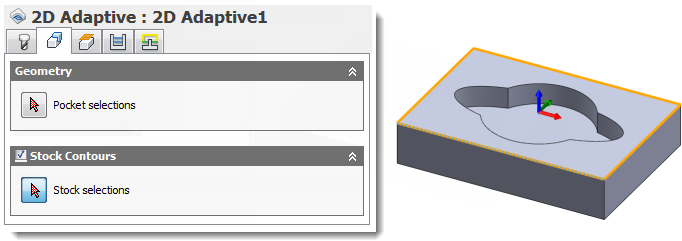

  1. On the Geometry tab, activate the Stock Contours check box, click the Stock selections button and select the stock contour for the facing operation.
    Selecting the stock contour
