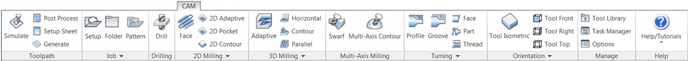

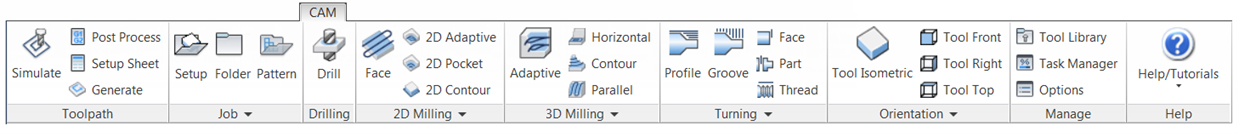

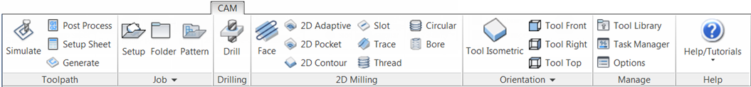

The command ribbons and the commands they offer for the three different versions of Autodesk HSM appear below:
The Inventor HSM Express command ribbon
The Inventor HSM command ribbon
The Inventor HSM Professional command ribbon

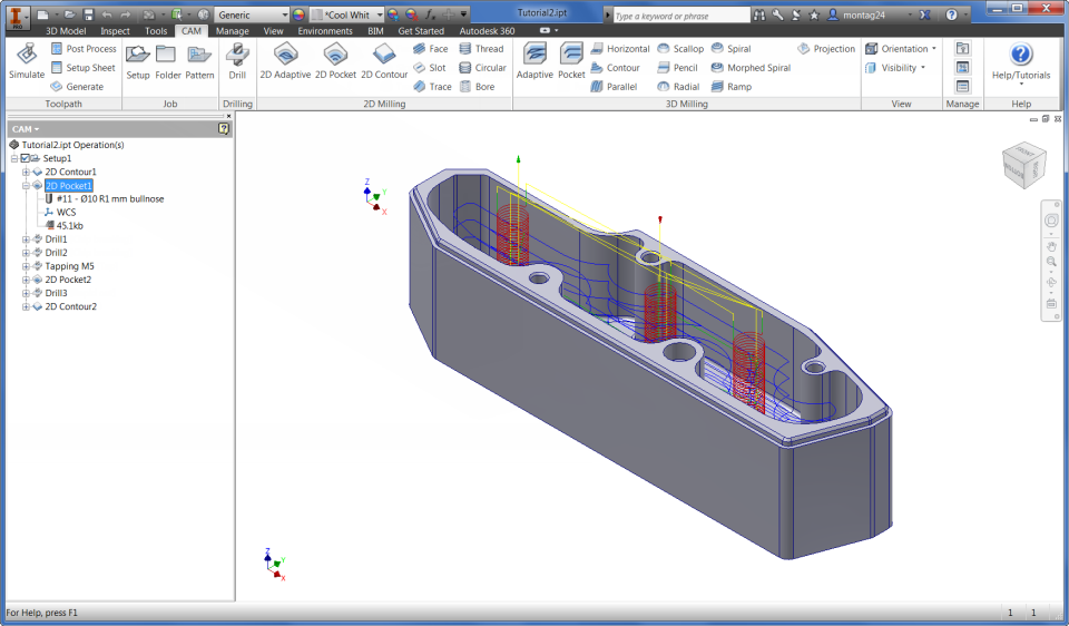

Once a part or assembly file is loaded and a strategy selected from the CAM ribbon, the CAM Browser becomes active replacing the familiar Inventor Model Browser. The CAM Browser lets you view and modify all machining-related data in the current part or assembly.
To create your first machining operation, simply select any of the toolpath strategies from the CAM toolbar. The type of toolpath required naturally depends on the geometry of your part. For a description of the individual machining strategies, please refer to the Autodesk HSM Help topics: About 2D Machining Strategies and About 3D Machining Strategies.
The following example illustrates a 2D Pocket strategy which is used to remove the interior cavity of a part .

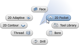

You select the first operation you wish to perform on the workpiece by clicking the appropriate icon from the command ribbon. In this example, you would click CAM tab 2D Milling panel 2D Pocket .
Remember: As an alternative, you can also right-click in an empty portion of the graphics window to display the familiar Inventor marking menu and click the appropriate marking menu node.

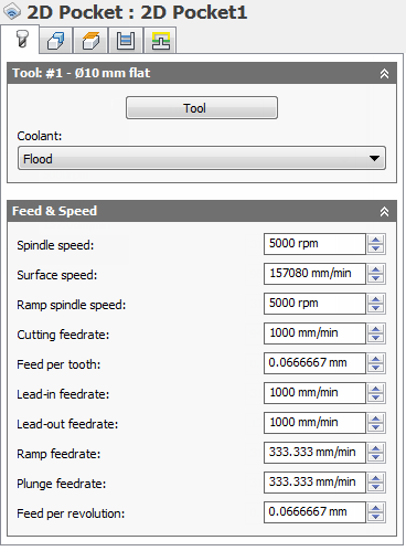

The Operation dialog box then replaces the CAM Browser at the left side of the graphics window, and prominently displays in its title bar the strategy name you selected. Just to the right of the strategy name is the operation number. Since this is the first 2D pocket operation for the part, the name displays as 2D Pocket1. The next 2D pocket operation will display as 2D Pocket2, and so on. This naming convention applies to all setup and machining strategies in Autodesk HSM.
The Operation dialog box for the 2D Pocket strategy. Note that the Tool tab is active by default..
The Operation dialog box contains a number of sections with parameters controlling different aspects of the toolpath whenever you create a new machining operation. Autodesk HSM provides working default values for all parameters, where possible. The only thing you need to do to obtain a toolpath is to select a tool and the geometry to be machined.
Tip: If you want to display both the Operation dialog box and the CAM Browser in two separate windows instead of combined, disable the Combine Operation dialog with CAM Browser setting on the User Interface tab in the CAM Options dialog box. For more information about CAM options, see the Help topic: CAM Options Reference.
Click the Tool button to open the Tool Library. Select an existing tool from a tool library by expanding the tree, selecting a tool, and clicking the OK button. Alternatively, you can create a new tool by clicking the New Mill Tool button, editing the parameters, and then clicking the Select button.
A Ø6 mm ball mill is selected from the Tool Library

Having successfully generated a toolpath, you can see a preview of the toolpath generated on top of the model simply by selecting the corresponding operation in the CAM Browser.
