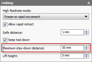

Autodesk HSM lets you control when you want to keep the tool down by setting Maximum stay-down distance which reduces the number of retracts. This setting is located on the Linking tab.
Enabling the Keep tool down check box and regenerating the toolpath operation shown below, produces the following results.
