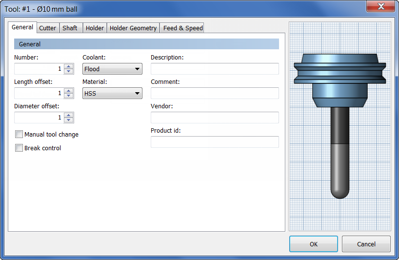

The number used to select the tool on the CNC machine.
The index of the tool length offset. This parameter is normally set when using tools with multiple tips indexed by length.
The index of the tool diameter offset.
Enable to force a manual tool change on machines with an automatic tool changer.
Enable to check for tool breakage after use.
The type of coolant used with the tool.
The tool material.
A textual description of the tool. This description is included in the tool name shown throughout Autodesk HSM.
A text comment for the tool. The comment is typically included in the post-processed output.
The vendor of the tool. Use this to identify the specific tool used.
The vendor's identifier (ID) for the tool. Use this to identify the specific tool used.

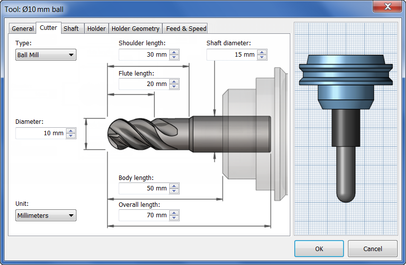

The type of the tool.
The diameter of the cutter.
The tool unit (Millimeters or Inches).
The tip diameter of the cutter.
The corner radius of the cutter.
The taper angle.
The angle of the tool tip. This angle is used to calculate the extra depth needed to break the tool through the material.
The tool flute length.
The tool shoulder length.
The tool body length.
Specifies the entire length of the tool.
The tool shaft/arbor diameter.
The pitch of the tap thread, specified as the vertical distance between the teeth of the tap.

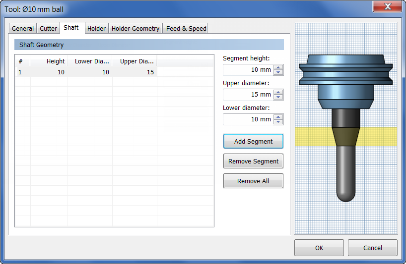

The height of the selected tool shaft segment.
The upper diameter of the selected tool shaft segment.
The lower diameter of the selected tool shaft segment.

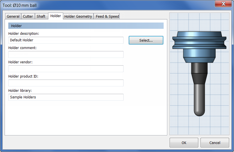

A textual description of the tool holder.
A text comment for the tool holder.
The vendor of the tool holder.
The vendor's identifier (ID) for the tool holder.
The library where the tool holder is stored.

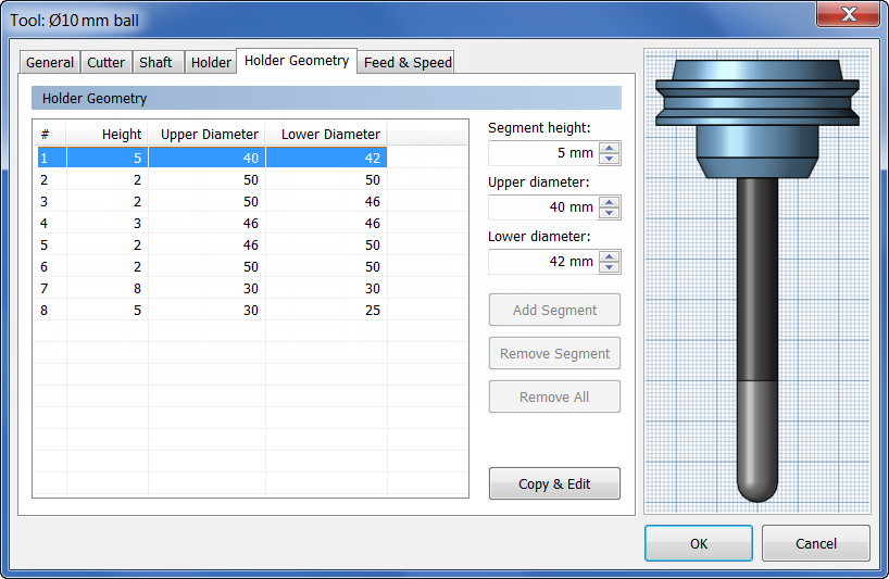

The height of the selected tool holder segment.
The upper diameter of the selected tool holder segment.
The lower diameter of the selected tool holder segment.

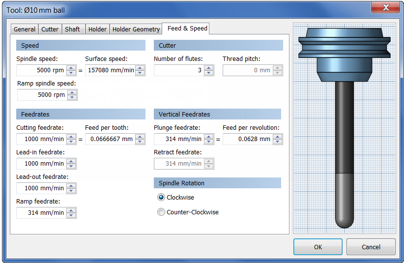

The rotational speed of the spindle.
The spindle speed expressed as the speed of the tool on the surface.
The rotational speed of the spindle when performing ramp movements.
The number of cutting flutes on the tool.
Feed used in cutting moves.
The cutting feedrate expressed as the feed per tooth.
Feed used when leading in to a cutting move.
Feed used when leading out from a cutting move.
Feed used when doing helical ramps into stock.
Feed used when plunging into stock.
The plunge feedrate expressed as the feed per revolution.
Feed used when retracting and not using rapid (G0) moves.
This option is active by default. All tools (except left-handed taps) rotate clockwise (M3).
If selected, spindle rotation is reversed.
