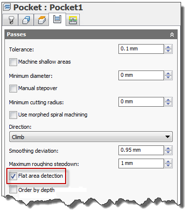

The 3D clearing strategies (Adaptive Clearing and Pocket Clearing) as well as the Contour finishing strategy have a setting on the Passes tab called Flat area detection. When enabled, the strategy detects all the flat areas and adjusts the stepdowns to ensure that the axial stock to leave is left on these flat areas.
The Flat area detection setting on the Passes tab
