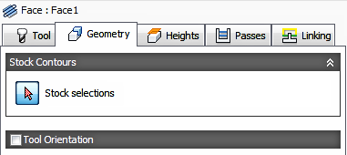

The Face toolpath assumes you want to machine the top of the stock to a depth of Z0. Generally No Selections Is Required For The Face Toolpath. The system will automatically face the size and shape of the Stock defined in the job Setup parameters. If you want to Face a specific area, use the Stock Selections option shown below. The stock area to machine is shown in Yellow.
No selection is required to machine the default Stock.
You can select any size or shape area to apply the Face toolpath. This area can be an Edge selection or a Sketch selection. No selection is needed if you want to face the area defined in the job Setup, Stock definition. The stock area to machine is shown in Yellow.

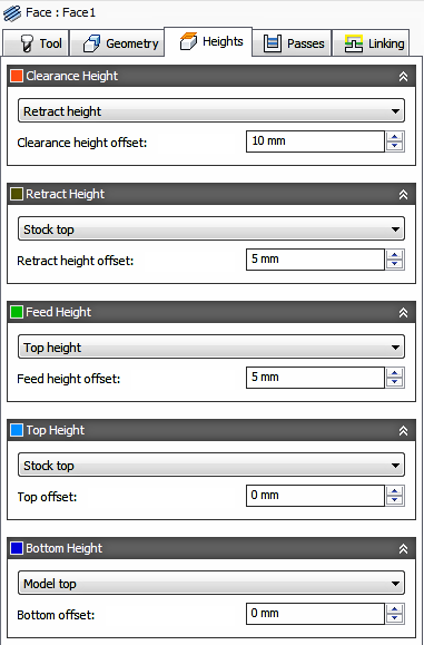

The Clearance height is the first height the tool rapids to on its way to the start of the tool path.
Clearance Height
The Clearance height offset is applied and is relative to the Clearance height selection in the above drop-down list.
Retract height sets the height that the tool moves up to before the next cutting pass. Retract height should be set above the Feed height and Top. Retract height is used together with the subsequent offset to establish the height.
Retract Height
Retract height offset is applied and is relative to the Retract height selection in the above drop-down list.
Feed height sets the height that the tool rapids to before changing to the feed/plunge rate to enter the part. Feed height should be set above the Top. A drilling operation uses this height as the initial feed height and the retract peck height. Feed height is used together with the subsequent offset to establish the height.
Feed Height
Feed height offset is applied and is relative to the Feed height selection in the above drop-down list.
Top height sets the height that describes the top of the cut. Top height should be set above the Bottom. Top height is used together with the subsequent offset to establish the height.
Top Height
Top offset is applied and is relative to the Top height selection in the above drop-down list.
Bottom height determines the final machining height/depth and the lowest depth that the tool descends into the stock. Bottom height needs to be set below the Top. Bottom height is used together with the subsequent offset to establish the height.
Bottom Height
Bottom offset is applied and is relative to the Bottom height selection in the above drop-down list.

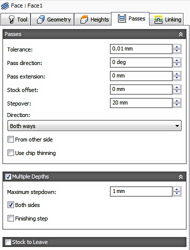

The tolerance used when linearizing geometry such as splines and ellipses. The tolerance is taken as the maximum chord distance.
![]() Loose Tolerance .100 |
![]() Tight Tolerance .001 |

Specifies the direction of the passes.
![]() Pass direction @ 0° |
![]() Pass direction @ 45° |
Distance to extend the passes beyond the machining boundary.
Pass extension
Specifies the distance to offset the stock contour outwards.
Stock offset
Specifies the horizontal stepover between passes. By default this value is 95% of the cutter diameter less the tool corner radius.
Horizontal stepover
The Direction option lets you control the cutting method. The default is to cut Both Ways, back and forth across the face. You may choose to cut in 1 direction by selecting either Climb or Conventional milling.
Specifies that the toolpath starts on the other side of the part.
![]() Unselected |
![]() Selected |
Enable to use a roll-on cut to keep the chips thin.
Specifies that multiple depths should be taken.
![]() With Multiple Depth cuts |
![]() Without Multiple Depth cuts |
Specifies the distance for the maximum stepdown between Z-levels. The maximum stepdown is applied to the full depth, less any remaining stock and finish pass amounts.
Enable to machine from both side of the part when multiple depth cuts are taken. The starting stepover is applied from each side of the part for each stepdown pass.
Specifies that a finishing step should be taken.
Finishing step
Feedrate used for the final finishing pass.
The size of each stepdown in the finishing passes.
Finishing stepdown

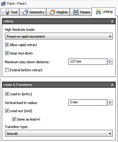

Specifies when rapid movements should be output as true rapids (G0) and when they should be output as high feedrate movements (G1).
This parameter is usually set to avoid collisions at rapids on machines which perform "dog-leg" movements at rapid.
The feedrate to use for rapids movements output as G1 instead of G0.
When enabled, retracts are done as rapid movements (G0). Disable to force retracts at lead-out feedrate.
When enabled, the strategy avoids retracting when the distance to the next area is below the specified stay-down distance.
Specifies the maximum distance allowed for stay-down moves.
![]() Full Retract |
![]() Minimum Retract |
Enable to extend the cutting pass beyond the stock before retracting.
Enable to generate a lead-in.
Lead-in
The radius of the vertical arc smoothing the entry move as it goes from the entry move to the toolpath itself.
Vertical lead-in radius
Enable to generate a lead-out.
Lead-out
Specifies that the lead-out definition should be identical to the lead-in definition.
Specifies the radius of the vertical lead-out.
Vertical lead-out radius
Specifies the type of connection between passes.
No Contact (not shown) Passes are not connected on the same Z level. The tool retracts between each connecting pass. |
