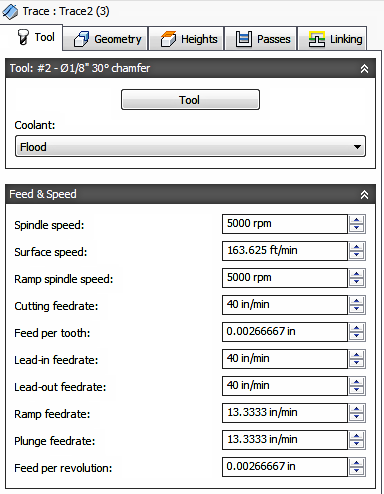

Select the type of coolant used with the machine tool. Not all types will work with all machine postprocessors.
Spindle and Feedrate cutting parameters.

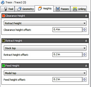

The Clearance height is the first height the tool rapids to on its way to the start of the tool path.
Clearance Height
The Clearance height offset is applied and is relative to the Clearance height selection in the above drop-down list.
Retract height sets the height that the tool moves up to before the next cutting pass. Retract height should be set above the Feed height and Top. Retract height is used together with the subsequent offset to establish the height.
Retract Height
Retract height offset is applied and is relative to the Retract height selection in the above drop-down list.
Feed height sets the height that the tool rapids to before changing to the feed/plunge rate to enter the part. Feed height should be set above the Top. A drilling operation uses this height as the initial feed height and the retract peck height. Feed height is used together with the subsequent offset to establish the height.
Feed Height
Feed height offset is applied and is relative to the Feed height selection in the above drop-down list.

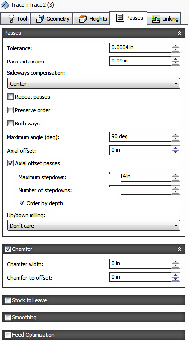

Distance to extend the passes beyond the machining boundary.
Pass extension
This setting determines the side of the toolpath from which the tool center is offset. Choose between Left (climb milling) sideways compensation or Right (conventional milling) sideways compensation.
![]() Climb Milling |
Right (conventional milling)![]() Conventional Milling |
Climb milling can be thought of as the cutter ''rolling along'' the surface that it is cutting. This generally gives a better finish in most metals, but requires good machine rigidity. Using this method, chips start at maximum thickness and get thinner towards the end of the cut, meaning more heat in the chip and less in the part.
With conventional milling, the cutter is ''rotating away'' from the surface it is cutting. This method is more commonly used with manual or less rigid machines. It does have some advantages, and can even give a better finish when machining certain materials including some woods.
Enable to perform the final finishing pass twice to remove stock left due to tool deflection.
Specifies that features are machined in the order in which they were selected. When unselected, Autodesk HSM optimizes the cut order.
Specifies that the operation uses both Climb and Conventional milling to machine open profiles.
![]() Unselected |
![]() Selected |
Limits the toolpath if the point of contact point slopes less than the angle specified.
Can be used to shift the selected curve up or down in the spindle axis.
Enable to do multiple depth cuts.
Axial offset passes are used to create multiple incremental Z passes in many of the 3D finishing strategies. They work much like multiple finishing stepdowns in the 2D operations and are useful for removing a fixed amount of stock using several passes.
![]() Shown with 4 cuts of .010 in |
![]() Three axial offset passes |
Specifies the maximum stepdown between Z-levels for roughing.
Maximum stepdown - shown without finishing stepdowns
Specifies the desired number of stepdowns.
This alters the order of the cuts when multiple curves are selected. When enabled, Order By Depth cuts all of a single curve before cutting the next curve.
Shown with 2 Edge Curves selected.
![]() Enabled Curve 1 is cut complete before curve 2. |
![]() Disabled Toolpath is generated by level cutting both curves. |
Use this option to break each pass into segments so that each piece is machined using either downward or upward moves only. This is useful when using insert cutters that are restricted to a specific cutting direction.
![]() Don't Care |
![]() Down Milling |
Only available if a Tapered or Chamfer tool is selected. Allows additional parameters to Chamfer a sharp edge, or a modeled Chamfer on the part.
Geometry Selection Tips:
![]() Sharp Corners Sharp Corners - Select the sharp corner and define the size of the chamfer using the Chamfer Width setting. |
![]() Chamfered Edges Chamfered Edges - Select the bottom edge of the chamfer. The chamfer width is calculated automatically. |
The amount to adjust the chamfer size.
![]() Chamfer width added to sharp edge |
The amount to extend the tool tip past the edge of the chamfer.

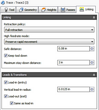

Controls how the tool moves between cutting passes. The following images are shown using the Flow strategy.
Full retraction - completely retracts the tool to the Retract Height at the end of the pass before moving above the start of the next pass. |
Minimum retraction - moves straight up to the lowest height where the tool clears the workpiece, plus any specified safe distance. |
Shortest path - moves the tool the shortest possible distance in a straight line between paths. |
For CNC machines that do not support linearized rapid moves, the post processor can be modified to convert all G0 moves to high-feed G1 moves. Contact technical support for more information or instructions how to modify post processors as described.
Specifies when rapid movements should be output as true rapids (G0) and when they should be output as high feedrate movements (G1).
This parameter is usually set to avoid collisions at rapids on machines which perform "dog-leg" movements at rapid.
The feedrate to use for rapids movements output as G1 instead of G0.
Minimum distance between the tool and the part surfaces during retract moves. The distance is measured after stock to leave has been applied, so if a negative stock to leave is used, special care should be taken to ensure that safe distance is large enough to prevent any collisions.
When enabled, the strategy avoids retracting when the distance to the next area is below the specified stay-down distance.
Specifies the maximum distance allowed for stay-down moves.
![]() 1" Maximum stay-down |
![]() 2" Maximum stay-down distance |
Enable to generate a lead-in.
Lead-in
The radius of the vertical arc smoothing the entry move as it goes from the entry move to the toolpath itself.
Vertical lead-in radius
Enable to generate a lead-out.
Lead-out
Specifies that the lead-out definition should be identical to the lead-in definition.
Specifies the radius of the vertical lead-out.
Vertical lead-out radius
