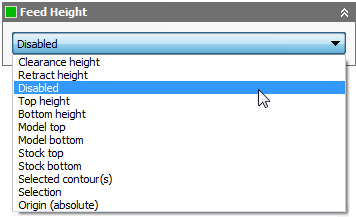

For 2D Contour and 2D Pocket, you have the option to disable the Feed Height which causes the tool to rapid down to the lead-in. Simply pick the Disabled option from the Feed Height drop-down list on the Heights tab.
Disabling the Feed Height
