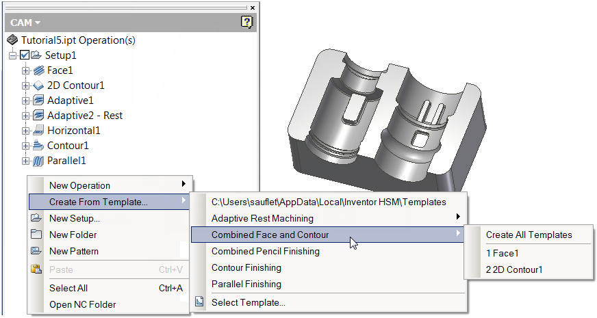

A new operation is created from a template using the Create from Template menu entry also available in the CAM Browser pop-up context menu. All templates stored in the last selected template folder are automatically listed under this menu entry. As shown in the image below, composite templates are listed as submenus allowing you to easily create either operations for all operation templates (Create All Templates), or from individual operation templates.
