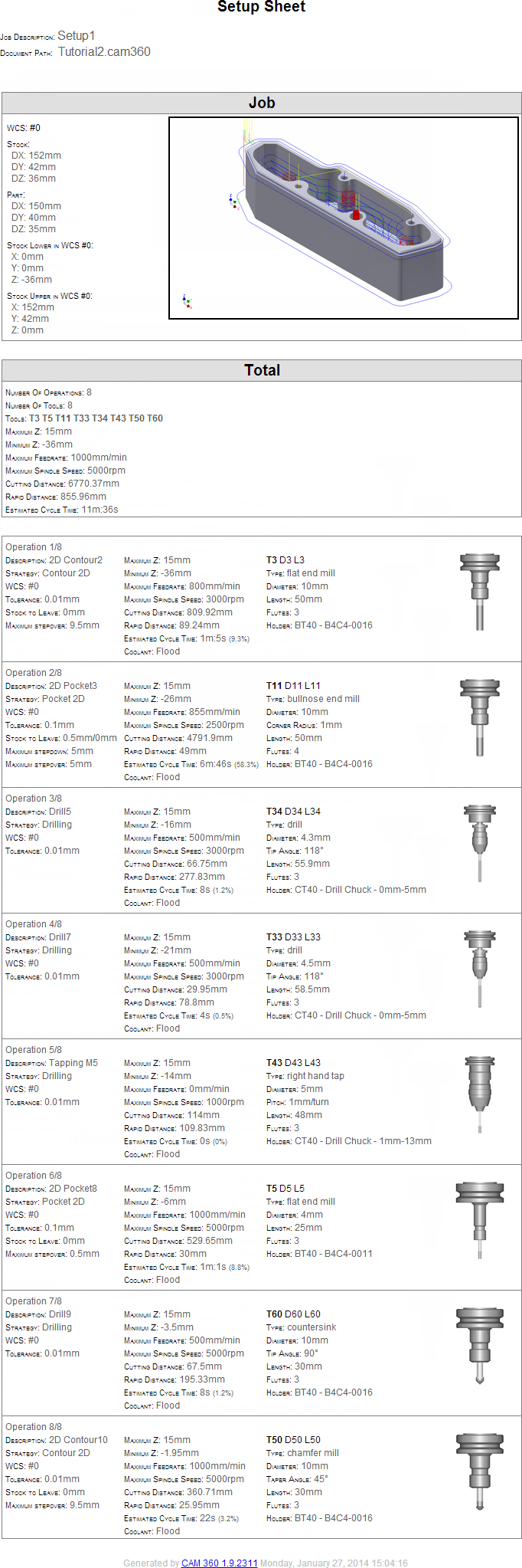

The Setup Sheet feature allows you to generate an overview of the NC program for the CNC operator. Autodesk HSM includes several setup sheets of which the HTML setup sheet is the default and is fully customizable.

Most setup sheets have common settings which can be used to adjust their behavior. The settings can be made in the Post Process dialog box. For instance, you can set the tool change time in seconds by setting toolChangeTime in the lower-right property list when selecting the HTML Setup Sheet called setup-sheet.cps.
Example setup sheet
