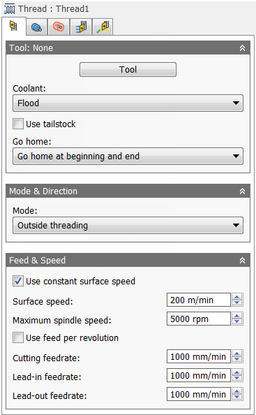

Tool tab settings
Coolant
Select the type of coolant that should be used with the tool. Output options will vary depending on the machine capabilities and machine postprocessor configuration.
Use Tailstock
A tailstock can be used to support the open end of the workpiece. This is particularly useful when the workpiece is relatively long and slender, or large and heavy. Failing to use a tailstock can cause the workpiece to flex while being cut, causing poor surface finish (chatter) and inaccuracies.
For this option to take effect, your machine needs a programmable tailstock and your post processor has to be configured to write the code your specific machine needs. Once configured, the post will output the appropriate code to extend the tailstock forward at the beginning of the operation and retract the tailstock backward at the end of the operation.
Go Home
The Home position is a retract point in Z, relative to the defined Work Coordinate System (WCS). WCS is defined in the Setup dialog, on the Setup tab.
You can force the tool to move to the Home position prior to starting the operation, or once the operation has finished. The tool will always pull out of the stock in the X axis until it reaches the Clearance height, then move to the Home position in the Z. If you use the same tool for several operations in a row, you can use these options to reduce wasted motion and keep the tool from returning to the Home position.
Don't go home
The tool will start at the Clearance Height above the first cut position. When finished, the tool will remain above the last move, at the Clearance Height.
Go home at beginning
The tool will start at the intersection of the Clearance Height and the Home Position. When finished, the tool will remain above the last move, at the Clearance Height.
Go home at end
The tool will start at the Clearance Height above the first cut position. When finished, the tool will return to the intersection of the Clearance Height and the Home Position.
Go home at beginning and end
The tool will start and end at the intersection of the Clearance Height and the Home Position.
Turning Mode
This setting determines whether the tool will machine on the Outside Diameter or the Inside Diameter of the part. This select also determines the approach/retract direction for the cut.
Outside Threading
The tool approaches from/retracts to the outside of the stock and machines along the spindle axis (axially).
Inside Threading
The tool approaches from/retracts to the centerline and machines axially.
Use constant surface speed
Enable to automatically adjust the spindle speed to maintain a constant surface speed between the tool and the workpiece as the cutting diameter changes . Constant Surface Speed (CSS) is specified using G96 on most machines.
Note: For more information, see the Autodesk HSM Help topic:About Turning Feeds & Speeds.
Surface Speed
The cutting speed expressed as the speed of the tool across the part surface. Expressed as Ft/min or M/min depending on the current Units setting.
Spindle Speed
The rotational speed of the spindle.
Maximum Spindle Speed
Specifies the maximum allowed spindle speed when using Constant Surface Speed (CSS).
Use Feed per Revolution
Enable to switch from Distance over Time (In/Min or MM/min), to Feed Per Revolution (IPR or MMPR). This type of feedrate creates a constant chip load regardless of the spindle RPM.
Cutting Feedrate
Feed used in cutting moves. Input based on the Use Feed per Revolution setting and the current Units.
Lead-In Feedrate
Feed used when leading in to a cutting move. Input based on the Use Feed per Revolution setting and the current Units.
Lead-Out Feedrate
Feed used when leading out from a cutting move. Input based on the Use Feed per Revolution setting and the current Units.

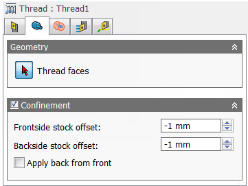

Geometry tab settings
Thread Faces
Selection button for faces to be threaded.
Confinement
Toolpaths can be contained within a specific region using the Confinement button to select confinement boundaries. Confinement regions can be defined with a combination of edges, surfaces, or sketch points.
Frontside Stock Offset
Specifies the distance to machine beyond the frontside of the model. Positive lengthens the starting position. Negative shortens the starting position and can actually start further into the part.
Zero Frontside Offset
Starts the toolpathat the edge of the stock.
Positive Frontside Offset
Starts the toolpath further away from the cutting area.
Backside Stock Offset
Specifies the distance to machine beyond the backside of the model. Positive lengthens the position at the end of the cut. Negative shortens the total threading distance, at the end of the cut.
Zero Backside Offset
Ends the toolpath at the end of the cutting area.
Negative Backside Offset
Ends the toolpath to shorten the cutting area.
Apply Back From Front
Makes the stock backside offset apply from the front side.

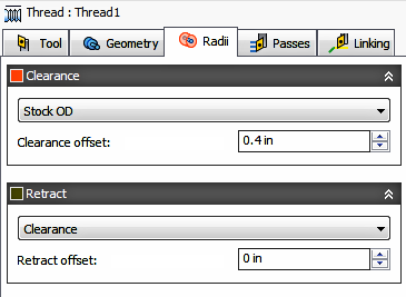

Radii tab settings
The Radii tab allows you to set a radial containment area for machining. These parameters are color coded for easy identification.
    Order for Radii Containment.
  • Clearance = Fully retracted safe zone
  • Retract = Above the surface to machine
Clearance
Shown in Orange, this controls the radius where the tool rapids to at the start and end of the toolpath. The tool approaches from and retracts to this position.
Shown in Orange, "From" sets the Clearance radius reference position. The reference can be in relation to the Stock, the Model, a specified Radius, Diameter, or any of the other Radial positions. This reference position can be shifted with a positive or negative offset value.
Note: The Clearance radius must be larger than, or equal to, the Retract, the Outer radius and Inner radius to generate a valid toolpath.
Offset
Use this offset to shift the position relative to the Reference point selected above. You can make positive or negative adjustments as needed.
    In This Example...
  • Outer = Stock OD (Model + 1mm stock)
  • Retract = Outer + 5mm Offset
  • Clearance = Retract + 5mm Offset
Retract
Shown in Dark Green, this controls the position above the surface you plan to machine. This is the radius where the tool retracts to between cuts.
Shown in Dark Green, "From" sets the Retract reference position. The reference can be in relation to the Stock, the Model, a specified Radius, Diameter, or any of the other Radial positions. This reference position can be shifted with a positive or negative offset value.
Offset
Same function as the Clearance Offset shown above.

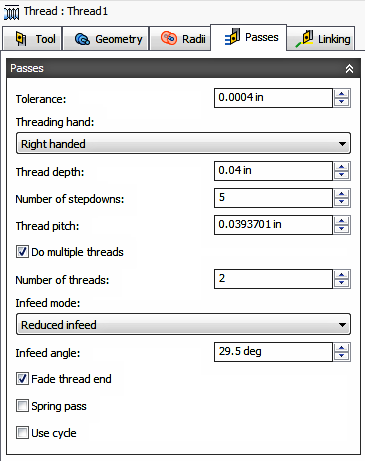

Passes tab settings
Tolerance
Also known as the Cut Tolerance, this Tolerance is for toolpath generation and geometry triangulation. Any additional filtering tolerances, like Smoothing, must be added to this tolerance to get the Total Tolerance for the cut..
Loose Tolerance .100
Tight Tolerance .001

Threading Hand
Right Handed Threads
Left Handed Threads
Thread Depth
Specifies the thread depth. Shown below as "T", the thread depth is the Major Dia. - Minor Dia. / 2. ( T = D - d ÷ 2 )
"D" = Major Dia. - "d" = Minor Dia. - "P" = Thread Pitch - "T" = Thread Depth
Number of Stepdowns
Specifies the number of cuts to complete the full thread depth.
Thread Pitch
Specifies the thread pitch. The Pitch is the distance of 1 thread. For inch threads it's 1 ÷ the number of threads per inch (TPI). A 1/2-13 thread the pitch would be 1÷13 = .0769. For metric threads the pitch is as stated. For an M16 x 2, the thread pitch is 2mm .
Do Multiple Threads
Enable to activate multiple lead threads.
Number of Threads
Specifies the number of thread leads.
Infeed Mode
The infeed is the depth of cut per pass and is critical in threading. The Infeed Mode is used to define how the tool should feed into the part. Each pass engages a larger portion of the cutting edge of the insert. There are three infeed mode options.
Constant infeed - With this option, the cutting force and metal removal rate can increase dramatically from one pass to the next. Example: When producing a 60 degree thread form using a constant 0.010 inch infeed per pass, the second pass removes three times the amount of metal as the first pass. The amount of metal removed continues to grow exponentially with each subsequent pass.
Reduced infeed - This option maintains more realistic cutting forces and reduces the depth of cut with each pass. It avoids the increased metal removal rate of constant infeed. Normally set to 1/2 the insert angle, or slightly less ( 60° ÷ 2 - .5° = 29.5°). This it is the recommended setting.
Alternate Flanking - This option is similar to Reduced infeed, but alternates the in-feed motion from side to side for each subsequent depth cut.
Infeed Angle
Specifies the infeed angle. Normally set to 1/2 the insert angle, or slightly less ( 60° ÷ 2 - .5° = 29.5°). This it is the recommended setting.
Fade Thread End
Enable to lift the thread off of the part gradually, just before reaching the end of the cut.
Spring Pass
Enable to perform the final finishing pass twice to remove stock left due to tool deflection. Also referred to as a spring cut.
Use Cycle
Enable to force the postprocessor to output the threading as canned cycle. May requires postprocessor modifications.
Number of Stepdowns
Specifies the desired number of increments to step down, to achieve the final depth.

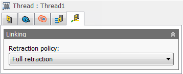

Linking tab settings
Retraction Policy
Controls how the tool should retract to the clearance diameter after every cutting pass. or just retract a short distance away from the job. The distance is determined by the Safe Distance value.
Full retraction - completely retracts the tool to the Retract Height at the end of the pass before moving above the start of the next pass. Minimum retraction - moves straight up to the lowest height where the tool clears the workpiece, plus any specified safe distance.
