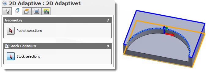

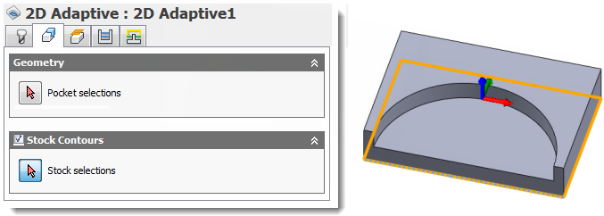

To machine an open 2D pocket using the 2D adaptive strategy, follow these steps:
2D Milling panel
2D Adaptive
to create a new 2D Adaptive Clearing operation.
Selecting the stock contour
Selecting the contour with the open pocket
