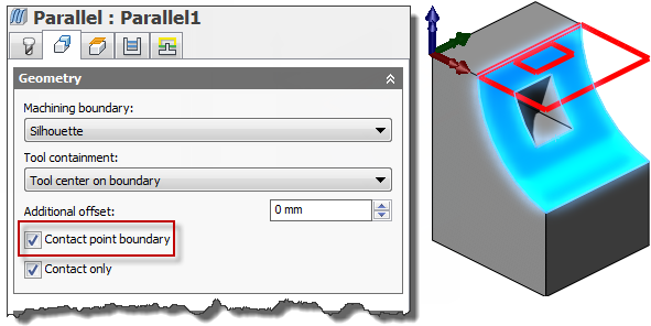

Selecting a face (or multiple faces) as the boundary for a 3D finishing operation provides an efficient way of limiting where the tool is machining.
By default, the boundaries confine the tool center points (i.e. the tool center must be inside the boundaries). If the slope of the selected face(s) vary around the edges, the result is either leftover material or machining extending outside the face(s) around the edges.
To avoid the problem, enable the setting Contact point boundary so that the boundaries limit the tool contact points rather than the tool center points.
Selecting a face as the machining boundary
