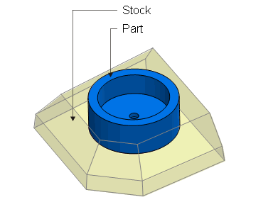

Adaptive Clearing supports stock definitions of any shape.
Irregular stock
  1. In Inventor, create the stock as a separate solid body.

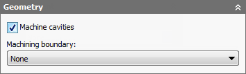

  3. Open the Adaptive Clearing parameters and set the machining boundary to None.
    No machining boundary

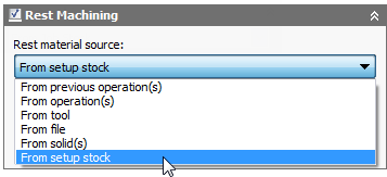

  4. Enable Rest Machining and set the Rest material source to From setup stock.
    Rest material source from setup stock
