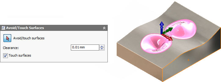

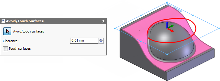

You can invert the meaning of the avoid surface by enabling the Touch surfaces check box. When enabled, the avoid surfaces are the ones that must be touched within the given clearance while the remaining surfaces are avoided.
The Touch surfaces option (disabled by default)
Touch surfaces disabled
Touch surfaces enabled
