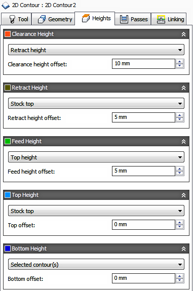

The Clearance height is the first height the tool rapids to on its way to the start of the tool path.
Clearance Height
The Clearance height offset is applied and is relative to the Clearance height selection in the above drop-down list.
Retract height sets the height that the tool moves up to before the next cutting pass. Retract height should be set above the Feed height and Top. Retract height is used together with the subsequent offset to establish the height.
Retract Height
Retract height offset is applied and is relative to the Retract height selection in the above drop-down list.
Feed height sets the height that the tool rapids to before changing to the feed/plunge rate to enter the part. Feed height should be set above the Top. A drilling operation uses this height as the initial feed height and the retract peck height. Feed height is used together with the subsequent offset to establish the height.
Feed Height
Feed height offset is applied and is relative to the Feed height selection in the above drop-down list.
Top height sets the height that describes the top of the cut. Top height should be set above the Bottom. Top height is used together with the subsequent offset to establish the height.
Top Height
Top offset is applied and is relative to the Top height selection in the above drop-down list.
Bottom height determines the final machining height/depth and the lowest depth that the tool descends into the stock. Bottom height needs to be set below the Top. Bottom height is used together with the subsequent offset to establish the height.
Bottom Height
Bottom offset is applied and is relative to the Bottom height selection in the above drop-down list.

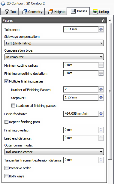

The tolerance used when linearizing geometry such as splines and ellipses. The tolerance is taken as the maximum chord distance.
![]() Loose Tolerance .100 |
![]() Tight Tolerance .001 |

This setting determines the side of the toolpath from which the tool center is offset. Choose between Left (climb milling) sideways compensation or Right (conventional milling) sideways compensation.
![]() Climb Milling |
Right (conventional milling)![]() Conventional Milling |
Climb milling can be thought of as the cutter ''rolling along'' the surface that it is cutting. This generally gives a better finish in most metals, but requires good machine rigidity. Using this method, chips start at maximum thickness and get thinner towards the end of the cut, meaning more heat in the chip and less in the part.
With conventional milling, the cutter is ''rotating away'' from the surface it is cutting. This method is more commonly used with manual or less rigid machines. It does have some advantages, and can even give a better finish when machining certain materials including some woods.
Specifies the compensation type.
This parameter specifies a range of tool diameters that can be safely used, instead of only the tool selected for the operation.
The allowed range of tool radii start from the selected tool radius and goes up to the selected tool radius, plus the given allowance.
Specifies that sharp corners must be forced.
The maximum amount of smoothing applied to the finishing passes. Use this parameter to avoid sharp corners in the toolpath. Setting this parameter leaves more stock than requested at the contour corners.
Enable to perform multiple finishing passes.
Specifies the number of finishing passes.
Shown with three finishing passes
The maximum distance between finishing passes.
Forces a full lead in and out on every finishing pass.
![]() Enabled |
![]() Disabled |
Feedrate used for the final finishing pass.
Enable to perform the final finishing pass twice to remove stock left due to tool deflection.
The finishing overlap is the distance that the tool passes beyond the entry point before leading out. Specifying a finishing overlap ensures that the material at the entry point is properly cleared.
![]() No finishing overlap |
![]() 0.25" finishing overlap |
Specifies the distance the lead-out feed rate begins before the end of the selected geometry.
![]() @ 0" |
![]() @ .5" |
When machining outer corners, it may be necessary to avoid rolling around the corner in order to leave the corner perfectly sharp.
The Outer corner mode setting lets you machine outer corners in three different ways.
![]() Roll around corner - keeps contact with the corner throughout the motion. |
![]() Keep sharp corner - continues the toolpath to a single point corner, losing contact with the material temporarily. |
![]() Keep sharp corner with loop - similar to Keep sharp corner, but also performs a horizontal lead-out and lead-in at the corner. |

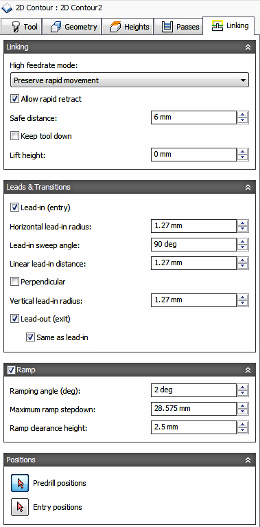

Used on open contours to extend the beginning and end of the calculated toolpath. This creates a tangent linear extension based on the angle of the start and endpoints. This extension can be used in combination with the Geometry - Tangential Extension Distance.
The extension distance may cause an overlap of the calculated toolpath. |
Specifies that features are machined in the order in which they were selected. When unselected, Autodesk HSM optimizes the cut order.
Specifies that the operation will use both Climb and Conventional milling to machine open profiles.
![]() Unselected |
![]() Selected |

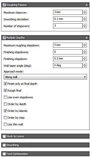

Enable to perform roughing passes.
Specifies the maximum stepover.
![]() With Minimum cutting radius set With Minimum cutting radius set - sharp corners in the toolpath are avoided minimizing chatter in finished parts. |
![]() Without Minimum cutting radius set Without Minimum cutting radius set - the toolpath attempts to remove material anywhere the selected tool can reach. This produces sharp corners in the toolpath that often leads to chatter in the machined part. |
The maximum amount of smoothing applied to the roughing passes. Use this parameter to avoid sharp corners in the toolpath.
The number of roughing steps.
Specifies that multiple depths should be taken.
![]() With Multiple Depth cuts |
![]() Without Multiple Depth cuts |
Specifies the maximum stepdown between Z-levels for roughing.
Maximum stepdown - shown without finishing stepdowns
The number of finishing passes using the bottom of the tool.
The size of each stepdown in the finishing passes.
Finishing stepdown
Specifies the taper angle of the walls.
Defining a slope angle can be used to machine features with a 2D strategy that would have otherwise required a 3D strategy.
![]() Slope angle @ 0 degrees |
![]() Slope angle @ 45 degrees |
Geometry Selection
![]() Bottom Selection |
![]() Top Selection |
Perform finishing passes only at the final depth to avoid leaving marks on the walls.
![]() Disabled |
![]() Enabled |
Enable to apply a finishing stepdown to every roughing pass/finishing pass when doing multiple depths with one or more finishing stepdowns.
Enable to create equal distances between machining passes.
Example: Suppose you are machining a profile with a depth of 23 mm and a maximum stepdown = 10 mm.
Specifies that the passes should be ordered top down.
![]() Disabled |
![]() Enabled |
Specifies in which order the depth cuts are taken when there are multiple profiles.
![]() Disabled Disabled - Depth cuts are ordered by depth. |
![]() Enabled Enabled - Depth cuts are ordered by profile. |
When enabled, each roughing and finishing step is machined to the full depth before moving to the next step.
![]() Disabled |
![]() Enabled |
When milling part features with wall thicknesses comparable to sheet metal stock, or even thinner, the stock is subjected to the forces generated by metal removal. This can result in the delicate structure of thin walls moving relative to the tool, making it difficult to maintain dimensional accuracy and impart the specified surface finish.
This option can be used to reduce the vibration and chatter by ensuring that both sides of a thin wall are machined at the same time.
The width of walls that should be considered thin walls.
Any wall with this width (or thinner) is machined on both sides at the same time to reduce vibration and chatter.

Smoothing works best when the Tolerance (the accuracy with which the original linearized path is generated) is equal to or greater than the Smoothing (line arc fitting) tolerance.
Specifies that the feed should be reduced at corners.
Specifies the maximum angular change allowed before the feedrate is reduced.
Specifies the minimum radius allowed before the feed is reduced.
Specifies the distance to reduce the feed before a corner.
Specifies the reduced feedrate to be used at corners.
Enable to only reduce the feedrate on inner corners.
Specifies when rapid movements should be output as true rapids (G0) and when they should be output as high feedrate movements (G1).
This parameter is usually set to avoid collisions at rapids on machines which perform "dog-leg" movements at rapid.
The feedrate to use for rapid movements output as G1 instead of G0.
When enabled, retracts are done as rapid movements (G0). Disable to force retracts at lead-out feedrate.
Minimum distance between the tool and the part surfaces during retract moves. The distance is measured after stock to leave has been applied, so if a negative stock to leave is used, special care should be taken to ensure that safe distance is large enough to prevent any collisions.
When enabled, the strategy avoids retracting when the distance to the next area is below the specified stay-down distance.
Specifies the maximum distance allowed for stay-down moves.
![]() 1" Maximum stay-down |
![]() 2" Maximum stay-down distance |
Specifies the lift distance during repositioning moves.
![]() Lift height 0 |
![]() Lift height .1 in |
Enable to generate a lead-in.
Lead-in
Specifies the radius for horizontal lead-in moves.
Horizontal lead-in radius
Specifies the sweep of the lead-in arc.
![]() Sweep angle @ 90 degrees |
![]() Sweep angle @ 45 degrees |
Specifies the length of the linear lead-in move for which to activate radius compensation in the controller.
Linear lead-in distance
Replaces tangential extensions of lead-in/lead-out arcs with a move perpendicular to the arc.
Shown with Perpendicular entry/exit
Example: A bore with lead arcs that are as large as possible (the larger the arc the less chance of dwell mark), and where a tangent linear lead is not possible because it would extend into the side of the bore.
The radius of the vertical arc smoothing the entry move as it goes from the entry move to the toolpath itself.
Vertical lead-in radius
Enable to generate a lead-out.
Lead-out
Specifies that the lead-out definition should be identical to the lead-in definition.
Specifies the length of the linear lead-out move for which to deactivate radius compensation in the controller.
Linear lead-out distance
Specifies the radius for horizontal lead-out moves.
Horizontal lead-out radius
Specifies the radius of the vertical lead-out.
Vertical lead-out radius
Specifies the sweep of the lead-out arc.
Example: A bore with lead arcs that are as large as possible (the larger the arc the less chance of dwell mark),and where a tangent linear lead is not possible because it would extend into the side of the bore.
Enable ramps.
Shown with a 15 degree Ramping angle
Specifies the maximum ramping angle of the helix during the cut.
Specifies the maximum stepdown per revolution on the ramping profile. This parameter allows the tool load to be constrained when doing full-width cuts during ramping.
The Height above the stock where the helix start its ramping move.
Select points where holes have been drilled to provide clearance for the cutter to enter the material.
Select geometry near the location where you want the tool to enter.
