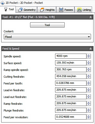

Tool tab settings
Coolant
Select the type of coolant used with the machine tool. Not all types will work with all machine postprocessors.
Feed & Speed

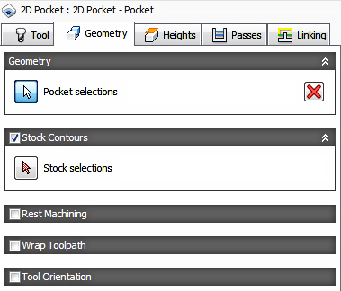

Geometry tab settings
Geometry
Select Faces, Edges or Sketches. You can remove stock from the inside of a pocket or the outside of a standing boss.
  1. Closed Pocket Machining
  2. Open Pocket Machining
  3. Standing Boss Machining
Pocket Selection
Select any Face, Edge or Sketch to define the machining boundary. Use Edge selection for areas with holes or pockets inside of pockets. For standing bosses select the outer boundary of the boss and check the Stock Contours option shown below. The toolpath will be calculated between the selected boundary and the outer stock area.
Select Faces, Edges or Sketches. Use Edge selection for areas with holes or pockets inside of pockets.
  1. Closed Pocket Face Selection
  2. Open Pocket Face Selection
  3. Standing Boss Edge Selection. Shown with stock boundary
Stock Contours
When checked, the toolpath is calculated to consider the boundaries of the defined Stock or a selected boundary. The default boundary is the Stock box specified in the Setup. You can also select Edges from the model or a Sketch boundary. This provides additional clearance for the Lead in and Lead out moves. This can limit or extend the stock machining area. Leave unchecked for closed boundary pockets.
Stock Selections - Select a closed boundary to define the machining area. No selection is needed to machine the Stock box specified in the Setup. Selecting a boundary larger than the stock extends the cutting area. This can be useful for irregular stock sizes. The selected machining boundary can be any shape.
Select Edges or Sketches to define the cutting boundary.
  1. Calculated from the Stock - No selection required
  2. A Sketch larger than the Stock extends the cutting area
  3. The selected area can be any size or shape
Note: This is not a containment boundary, since the tool will approach from outside the selected area.
Rest Machining
Limits the operation to just remove material that a previous tool or operation could not remove.
Rest Machining ON
Rest Machining OFF
Tool diameter:
Specifies the diameter of the rest material tool.
Corner radius:
Specifies the corner radius of the rest material tool.

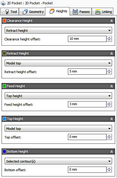

Heights tab settings
Clearance Height
The Clearance height is the first height the tool rapids to on its way to the start of the tool path.
Clearance Height
Clearance height offset:
The Clearance height offset is applied and is relative to the Clearance height selection in the above drop-down list.
Retract Height
Retract height sets the height that the tool moves up to before the next cutting pass. Retract height should be set above the Feed height and Top. Retract height is used together with the subsequent offset to establish the height.
Retract Height
Retract height offset:
Retract height offset is applied and is relative to the Retract height selection in the above drop-down list.
Feed Height
Feed height sets the height that the tool rapids to before changing to the feed/plunge rate to enter the part. Feed height should be set above the Top. A drilling operation uses this height as the initial feed height and the retract peck height. Feed height is used together with the subsequent offset to establish the height.
Feed Height
Feed height offset:
Feed height offset is applied and is relative to the Feed height selection in the above drop-down list.
Top Height
Top height sets the height that describes the top of the cut. Top height should be set above the Bottom. Top height is used together with the subsequent offset to establish the height.
Top Height
Top offset:
Top offset is applied and is relative to the Top height selection in the above drop-down list.
Bottom Height
Bottom height determines the final machining height/depth and the lowest depth that the tool descends into the stock. Bottom height needs to be set below the Top. Bottom height is used together with the subsequent offset to establish the height.
Bottom Height
Bottom offset:
Bottom offset is applied and is relative to the Bottom height selection in the above drop-down list.

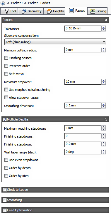

Passes tab settings
Tolerance:
The tolerance used when linearizing geometry such as splines and ellipses. The tolerance is taken as the maximum chord distance.
Loose Tolerance .100
Tight Tolerance .001
CNC machine contouring motion is controlled using line G1 and arc G2 G3 commands. To accommodate this, CAM approximates spline and surface toolpaths by linearizing them creating many short line segments to approximate the desired shape. How accurately the toolpath matches the desired shape depends largely on the number of lines used. More lines result in a toolpath that more closely approximates the nominal shape of the spline or surface.
Data Starving
It is tempting to always use very tight tolerances but there are trade-offs including longer toolpath calculation times, large G-code files, and very short line moves. The first two are not much of a problem because Autodesk HSM calculates very quickly and most modern controls have at least 1MB of RAM. However, short line moves, coupled with high feedrates, may result in a phenomenon known as data starving.
Data starving occurs when the control becomes so overwhelmed with data that it cannot keep up. CNC controls can only process a finite number of lines of code (blocks) per second. That can be as few as 40 blocks/second on older machines and 1,000 blocks/second or more on a newer machine like the Haas Automation control. Short line moves and high feedrates can force the processing rate beyond what the control can handle. When that happens, the machine must pause after each move and wait for the next servo command from the control.
Sideways compensation:
This setting determines the side of the toolpath from which the tool center is offset. Choose between Left (climb milling) sideways compensation or Right (conventional milling) sideways compensation.
Climb Milling
Conventional Milling
Climb milling can be thought of as the cutter ''rolling along'' the surface that it is cutting. This generally gives a better finish in most metals, but requires good machine rigidity. Using this method, chips start at maximum thickness and get thinner towards the end of the cut, meaning more heat in the chip and less in the part.
With conventional milling, the cutter is ''rotating away'' from the surface it is cutting. This method is more commonly used with manual or less rigid machines. It does have some advantages, and can even give a better finish when machining certain materials including some woods.
Finishing passes
Enable to perform finishing passes using the side of the tool.
With Finishing passes
Without Finishing passes
Number of finishing passes:
Forces a full lead in and out on every finishing pass.
Enabled
Disabled
Note: Lead parameters are set on the Linking tab.

Finish feedrate:
The feedrate used for the final finishing pass.
Repeat finishing pass
Enable to perform the final finishing pass twice to remove stock left due to tool deflection.
Finishing overlap:
The finishing overlap is the distance that the tool passes beyond the entry point before leading out. Specifying a finishing overlap ensures that the material at the entry point is properly cleared.
No finishing overlap
0.25" finishing overlap
Note: The finishing overlap follows the selected contour, so it is safe to specify a large overlap.
Preserve order
Specifies that features are to be machined in the order in which they were selected. When unselected, Autodesk HSM optimizes the cut order.
Both Ways
Specifies that the operation uses both Climb and Conventional milling to machine open profiles.
Maximum stepover:
Specifies the maximum horizontal stepover between passes.
Note: This is NOT the same as optimal load settings with adaptive clearing paths. With legacy 2D roughing, the tool still sees full cutter engagement when transitioning from one pass to the next.
Adaptive clearing
Legacy 2D clearing
Minimum cutting radius:
With Minimum cutting radius set
Without Minimum cutting radius set
Without Minimum cutting radius set - The toolpath attempts to remove material anywhere the selected tool can reach. This produces sharp corners in the toolpath that often leads to chatter in the machined part.
Note: Setting this parameter leaves more material in internal corners requiring subsequent rest machining operations with a smaller tool.
Use morphed spiral machining
Enable to create a constant spiral move toolpath for the pocket. This can provide a smooth run on the machine.
Standard 2D pocket toolpath
Morphed spiral 2D pocket toolpath
Allow stepover cusps
When programming flat faces with a tool that has a radius in the corner, a cusp (or Scallop) can be produced between stepovers.
By default, the Maximum stepover value is overridden to insure that no stepover cusps are produced.
Allow stepover cusps disabled
Allow stepover cusps enabled
Above - Pocket machined with a 3/8" bullnose end mill @ 0.25" maximum stepover.
Smoothing deviation:
The maximum amount of smoothing applied to the roughing passes. Use this parameter to avoid sharp corners in the toolpath.
Multiple Depths
Specifies that multiple depths should be taken.
With Multiple Depth cuts
Without Multiple Depth cuts
Note: Adaptive clearing strategies allow for much more aggressive depth cuts than legacy 2D pockets.

Smoothing tolerance:
Specifies the smoothing filter tolerance.
Smoothing works best when the Tolerance (the accuracy with which the original linearized path is generated) is equal to or greater than the Smoothing (line arc fitting) tolerance.
Note: Total tolerance, or the distance the toolpath can stray from the ideal spline or surface shape, is the sum of the cut Tolerance and Smoothing Tolerance. For example, setting a cut Tolerance of .0004 in and a Smoothing Tolerance of .0004 in means the toolpath can vary from the original spline or surface by as much as .0008 in from the ideal path.
Feed Optimization
Specifies that the feed should be reduced at corners.
Maximum directional change:
Specifies the maximum angular change allowed before the feedrate is reduced.
Reduced feed radius:
Specifies the minimum radius allowed before the feed is reduced.
Reduced feed distance:
Specifies the distance to reduce the feed before a corner.
Reduced feedrate:
Specifies the reduced feedrate to be used at corners.
Only inner corners
Enable to only reduce the feedrate on inner corners.

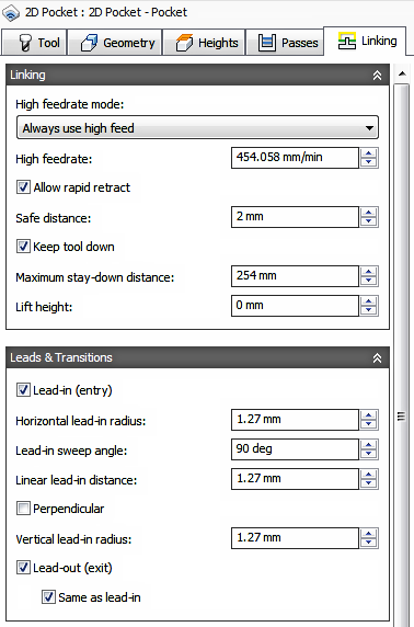

Linking tab settings
High feedrate mode:
Specifies when rapid movements should be output as true rapids (G0) and when they should be output as high feedrate movements (G1).
This parameter is usually set to avoid collisions at rapids on machines which perform "dog-leg" movements at rapid.
High feedrate:
The feedrate to use for rapids movements output as G1 instead of G0.
Allow rapid retract
When enabled, retracts are done as rapid movements (G0). Disable to force retracts at lead-out feedrate.
Safe distance:
Minimum distance between the tool and the part surfaces during retract moves. The distance is measured after stock to leave has been applied, so if a negative stock to leave is used, special care should be taken to ensure that the safe distance is large enough to prevent any collisions.
Keep tool down
When enabled, the strategy avoids retracting when the distance to the next area is below the specified stay-down distance.
Maximum stay-down distance:
Specifies the maximum distance allowed for stay-down moves.
1" Maximum stay-down
2" Maximum stay-down distance
Lift height:
Specifies the lift distance during repositioning moves.
Lift height 0
Lift height .1 in
Lead-in (entry)
Enable to generate a lead-in.
Lead-in
Horizontal lead-in radius:
Specifies the radius for horizontal lead-in moves.
Lead-in sweep angle:
Specifies the sweep of the lead-in arc.
Sweep angle @ 90 degrees
Sweep angle @ 45 degrees
Linear lead-in distance:
Specifies the length of the linear lead-in move for which to activate radius compensation in the controller.
Perpendicular
Replaces tangential extensions of lead-in/lead-out arcs with a move perpendicular to the arc.
Shown with Perpendicular entry/exit
Example: A bore that has lead arcs that are as large as possible (the larger the arc the less chance of dwell mark), and where a tangent linear lead is not possible because it would extend into the side of the bore.
Vertical lead-in radius:
The radius of the vertical arc smoothing the entry move as it goes from the entry move to the toolpath itself.
Lead-out (exit)
Enable to generate a lead-out.
Lead-out
Same as lead-in
Specifies that the lead-out definition should be identical to the lead-in definition.
Linear lead-out distance:
Specifies the length of the linear lead-out move for which to deactivate radius compensation in the controller.
Horizontal lead-out radius:
Specifies the radius for horizontal lead-out moves.
Vertical lead-out radius:
Specifies the radius of the vertical lead-out.
Lead-out sweep angle:
Specifies the sweep of the lead-out arc.
Perpendicular
Example: A bore that has lead arcs that are as large as possible (the larger the arc the less chance of dwell mark) and where a tangent linear lead is not possible because it would extend into the side of the bore.

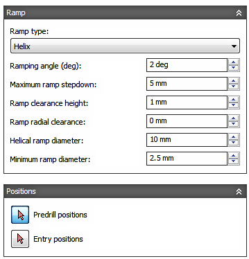

Ramp type:
Specifies how the cutter moves down for each depth cut.
Plunge Outside Stock
Zig-Zag
Notice the smooth transitions on the Zig-Zag ramp type.
Predrill
To use the Predrill option, Predrill location(s) must be defined.
Profile
Plunge
Smooth Profile
Helix
Ramping Angle (deg)
Specifies the maximum ramping angle of the helix during the cut.
Maximum ramp stepdown:
Specifies the maximum stepdown per revolution on the ramping profile. This parameter allows the tool load to be constrained when doing full-width cuts during ramping.
Ramp Clearance Height
The Height above the stock where the helix start its ramping move.
Ramp radial clearance:
Specifies the minimum distance to the contour for the lead-in helix.
Helical Ramp Diameter
The maximum diameter to use for a helical entry into the cavity.
An optimal value causes the tool to overlap it's center, while still creating the maximum helical bore for the entry into the cavity. The goal is for good chip evacuation. If the value is bigger than the diameter of the tool it can leave a boss standing in the center of the helix.
Value of 1.8 x the Dia.
Value of 0.8 x the Dia.
Minimum Ramp Diameter
The smallest Helix Ramp Diameter that is acceptable.
This value should always be smaller than the Helix Ramp Diameter, so the system can calculate a range that fits the available pocket or channel. Smaller diameters can reduce the chip evacuation, create jerking machine motion and can cause tool breakage.
Predrill positions
Select points where holes have been drilled to provide clearance for the cutter to enter the material.
Entry positions
Select geometry near the location where you want the tool to enter.
