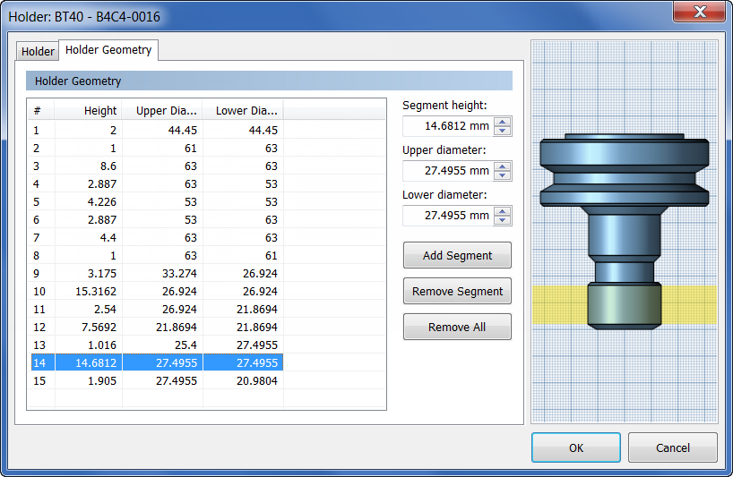

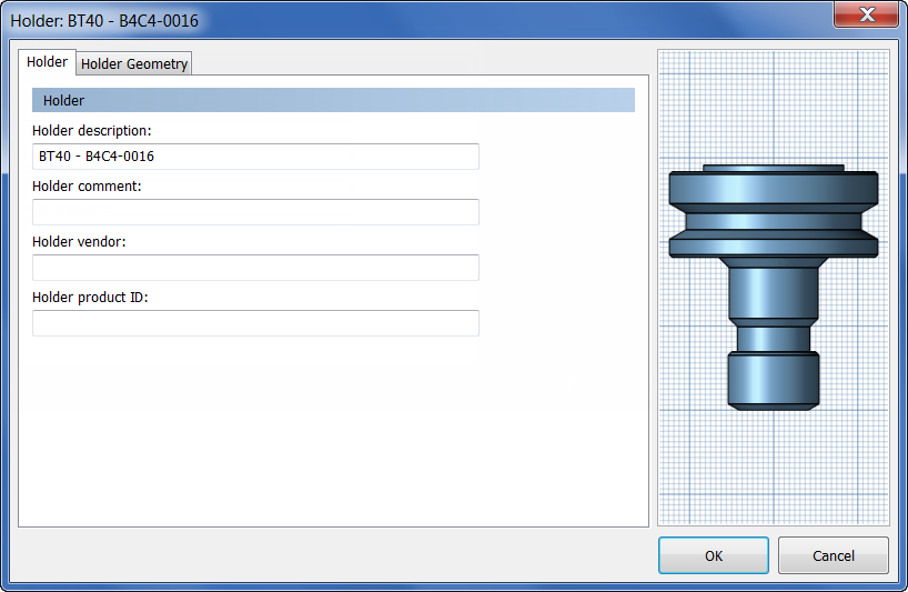

The New Mill Holder dialog box lets you edit an individual mill holder and is divided into two tabs:
The preview on the right side of the dialog shows the shape of the holder and is automatically updated to reflect changes to the holder.
A textual description of the tool holder.
A text comment for the tool holder.
The vendor of the tool holder.
The vendor's identifier (ID) for the tool holder.
The height of the selected tool holder segment.
The upper diameter of the selected tool holder segment.
The lower diameter of the selected tool holder segment.
