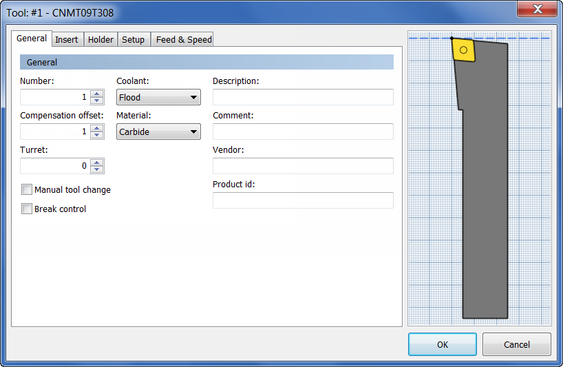

The number used to select the tool on the CNC machine.
The index of the tool compensation offset used for turning.
Specifies the turret of the tool.
Enable to force a manual tool change on machines with an automatic tool changer.
Enable to check for tool breakage after use.
The type of coolant used with the tool.
The tool material.
A textual description of the tool. This description is included in the tool name shown throughout Autodesk HSM.
A text comment for the tool. The comment is typically included in the post-processed output.
The vendor of the tool. Use this to identify the specific tool used.
The vendor's identifier (ID) for the tool. Use this to identify the specific tool used.

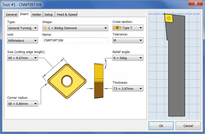

The type of the tool.
The tool unit (Millimeters or Inches).
Specifies the shape of the insert.
Coding system of numbers and letters to describe the insert shape, dimensions, and important parameters.
The size of the insert.
The corner radius of the insert.
Specifies the hole and chip breaker shape of the insert.
This is how much variation is allowed in the dimensional size of the insert.
Specifies the draft on the face(s) of the insert that contacts material during machining.
The thickness of the insert.

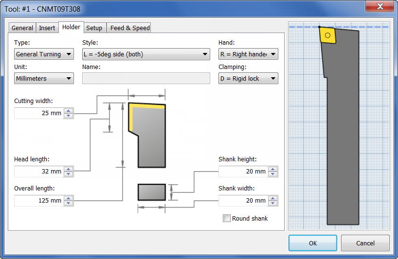

Specifies the shape of the holder.
The side of the tool with respect to the part.
Specifies how the insert is fixed to the holder.
The width of the holder head.
The length of the holder head.
Specifies the entire length of the holder.
The height of the holder shank.
The width of the holder shank.
Enabling this option specifies a cylindrical shank for the holder.

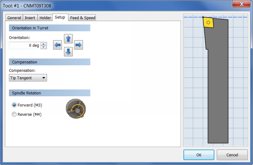

The angle of the tool with respect to the cutting direction.
Specifies the compensation type for the tool.
The spindle rotates clockwise.
If selected, spindle rotation is reversed.

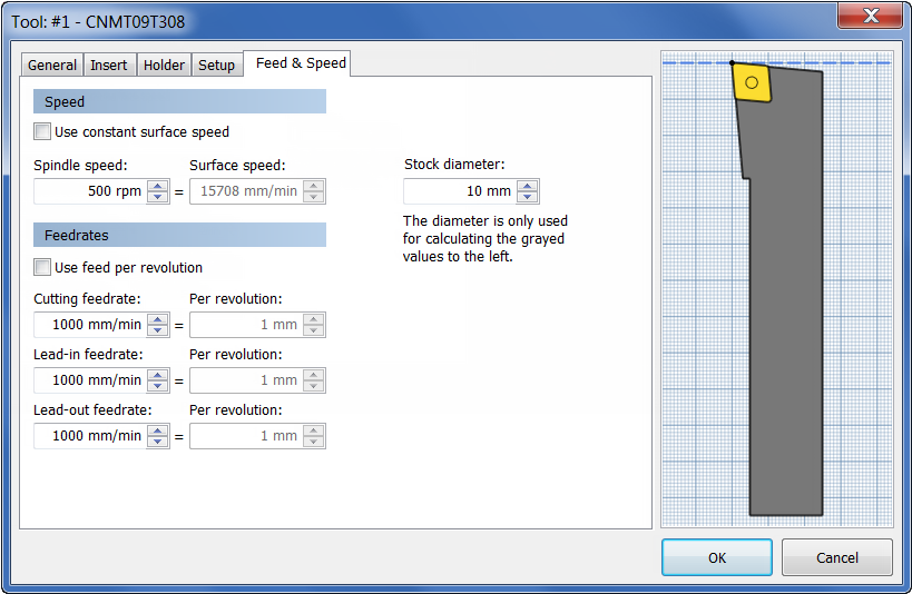

Use constant surface speed.
The rotational speed of the spindle.
The spindle speed expressed as the speed of the tool on the surface.
Use feed per revolution.
Feed used in cutting moves.
Feed used when leading in to a cutting move.
Feed used when leading out from a cutting move.
The diameter of the cutter.
