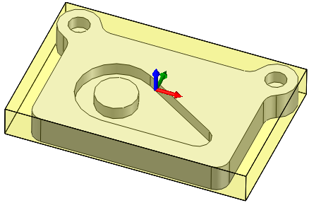

You can quickly preview the stock for a setup by selecting the setup name at the top of the CAM Browser. This feature allows you to immediately verify that the stock has been set up properly without editing the setup or entering stock simulation. The stock preview is automatically hidden when an operation is inactive.
Previewing the stock for a selected setup
