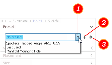

Preset Interface
  1. Drop down list of presets.
  2. Creates a new preset from the current parameters. A default name is provided, but can be changed.
  3. Preset Settings, which includes
    1. Save Current - save the current settings to a preset you name or use the default name.
    2. Rename Current - provide a different name for the current preset. When renaming a preset, you can use the Esc key to exit the process and restore the previous name.
    3. Delete Current - select the preset you want to delete, then click Delete Current.
    4. Sort Order
      1. Recently Used - ordered by most recent use
      2. Date created - ordered by the oldest preset to the newest preset
      3. Alpha-Numeric - ordered by numeral and then alphabetically
      4. Last modified - ordered by most recently modified

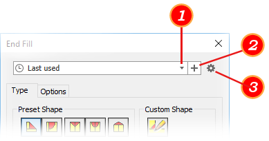

Presets for Legacy Commands
The following legacy Drawing commands use the Presets capability:
  • End Fill
  • Weld Symbols
  • Surface Texture Symbols
