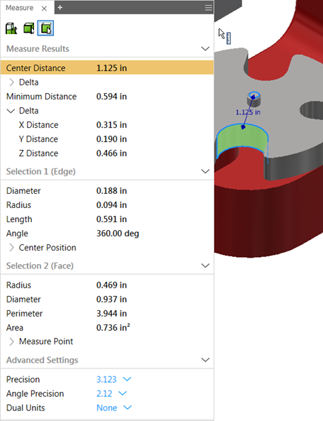

Measure Linear Distance, Length, Angle, Loop, or Area
Information on each selection displays in the measure tool panel and in the graphics window. The Measure tool panel shows all possible values for your selections as well as the result from both selections. Clicking a value in the Measure tool panel displays the selection and the measurement in the graphics window.

  4. In the graphics window, click to select geometry to measure:
    • Length of an edge Click to select the edge.
    • Diameter of a cylindrical face or circle Pause the cursor over the cylindrical face or circle until a diameter line appears, and then click to select it.
    • Radius of a cylindrical face or arc Pause the cursor over the cylindrical face or circle until a radius line appears, and then click to select it.
    • Position of a point from the origin Click to select the point. The position of the point relative to each axis of the active coordinate system displays.
    • Distance between points Click to select the first point, and then click to select the second point. When you select the second point, the position of the point from the origin and delta position relative to the first point displays.
    • Distance between any 2 of the following geometries: Lines/axis, arcs/circles, splines and any type of surfaces Click to select the first geometry, and then click to select the second geometry.
    • Distance between two components in an assembly (not available in Inventor LT) Select the first component, and then select the second component. A minimum distance value displays. The minimum distance between two components can be an edge, face, or vertex.
      Note: Changing the priority also changes the type of minimum distance measurement you can perform, such as minimum distance between components or parts. The command defaults to Select Faces and Edges priority. When you use Component Priority in an assembly, you can select only components as valid selections, not faces. Changing the selection priority after the first selection resets the command.
    • Arc length Select an arc.
    • Angle Use one of the following methods:
      • Select 2 lines, edges, or faces.
      • Select 2 points, and then hold down SHIFT and select the third point of the angle.
      • Select an arc or circle.
      • Select a line or axis and then select a planar faces.
    • Area and loop Select the contiguous, enclosed region to measure.

    Note:
    • Minimum Distance and Center to Center Distance display at the same time when at least one of the following types of geometry are selected:
      • Arc/Circle
      • Ellipse
      • Cylinder/Cone/Torus
      • Sphere
    • Maximum Distance displays when 2 of the following types of geometry, on the same plane, are selected:
      • Vertex
      • Line
      • Arc
      • Circle
