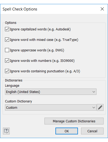

- Click Options to access the
Spell Check Options dialog box.
- Select one or more check boxes to exclude one or more conditions from the spell check operation.
- Select a language-specific dictionary to use as your main dictionary. These dictionaries install with Inventor. This dictionary is used in conjunction with the custom dictionary.

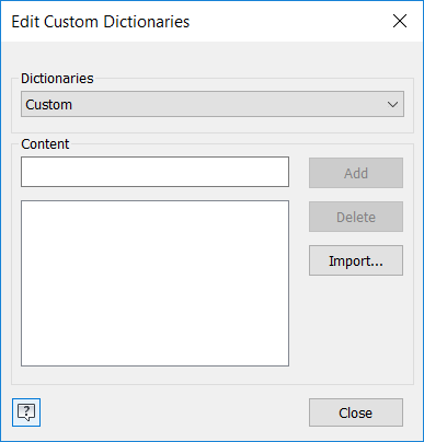

- Click
Edit to access the
Edit Custom Dictionaries dialog box. Here you can directly add words to, or remove words from the active custom dictionary. You can also import the words in one custom dictionary and add them to the active dictionary.
- To add words: Enter a word in the Content text field and click Add.
- To delete a word: Select a word in the Content text field and click Delete.
- To import words from a dictionary into the active custom dictionary: Click Import, and then browse to the location of the custom dictionary (.cus) file whose words you want to add. Click Open to import the words.
