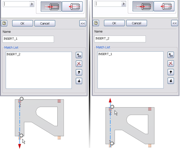

In this example, multiple instances of a component are assembled in ladder form. To accomplish it, an iMate match list is created so Post 1 is always placed into Hole 2.
  - Create an iMate insert constraint named Insert_1 on Post 1. Expand the dialog box and create the preferred match (Insert_2) as the first entry in the match list.
- Create an iMate insert constraint named Insert_2 on Hole 2. Expand the dialog box and create the preferred match (Insert_1) as the first entry in the match list.
- Place the first instance of the component into an assembly.
- Place the second instance of the component using the Place Component dialog box. Enable either iMate option (Interactively place with iMates, or Automatically generate iMates on place).
Note: To constrain fully on placement, follow these steps to create Insert_3 and Insert_4 on the remaining features.
