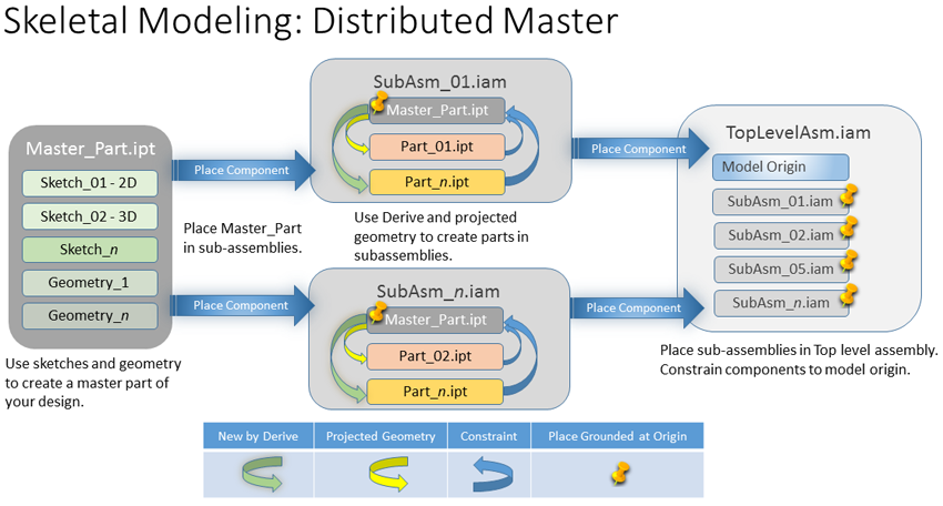

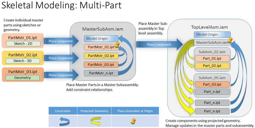

Skeletal Modeling Methods
No single method suits every design process. You refine your use of the tools to develop efficient processes for producing their designs. Skeletal modeling is an example of that refinement process. Using the tools, customers, like you, have developed approaches to skeletal design that fit their needs. The following methods represent the best practices for using skeletal design methods.
The Single-Level Process uses a single master part containing sketches and geometry that represents the final design. The Master part is placed in the top-level assembly. All components (parts and subassemblies) are created relative to the Master part. Downstream, modifications to the Master part drive changes in the components associated to the Master part.
The Multi-Level Process uses individual master parts comprised of sketches to represent the final assembly. The master parts are placed and constrained in a Master sub-assembly. The Master sub-assembly is placed in the Top-level assembly. Inside the Top-level assembly, the individual 3D components are modeled using projected geometry from the Master sub-assembly and its master parts. The 3D components can be contained in logical sub-assemblies or separate, according to the design requirements.
The Distributed Master uses a single master part, comprised of sketches and geometry, to define the final assembly. The Master Part is referenced in the various sub-assemblies and parts as needed. The Master Part controls the overall layout. The assembly and sub-assemblies are defined or placed with respect to the Master Part. Each sub-assembly has its own skeleton and drive a portion of the design within itself. Higher level skeletons are used to drive the overall layout or mechanism of the assembly while lower level skeletons can be used to drive the geometry of the parts.

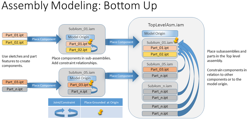

Bottom-up
Bottom Up is the traditional way of building assemblies. First, you define the different parts. Then, you put them into sub-assemblies using assembly constraints. The sub-assemblies are then placed into higher lever assemblies up to the top level assembly and in this way, you are working your way from the bottom up. This assembly method results in assemblies with a number of relationships between parts and assemblies.
This approach can lead to two things:
  1. It can consume system resources and slow down performance.
  2. Model changes ripple through the design due to a lot of cross references and/or referenced geometry that are affected.
This diagram is provided as a comparison to the skeletal modeling methods mentioned above.

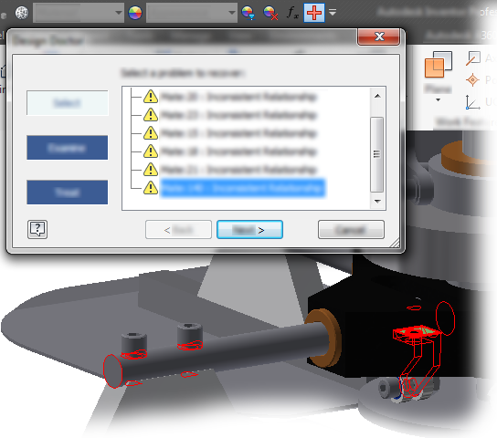

Resolve Relationship errors
It is a good practice to resolve all relationship errors as they occur. However, attempting to resolve all constraint errors through in-place editing, starting at the top level, is an inefficient use of time.
When resolve errors occur a red cross displays in the Quick Access Toolbar (QAT). Clicking that button launches the Design Doctor which reports the errors. In the dialog box, select an error to highlight where the error occurs.
The most efficient way to resolve relationship errors is to:
  1. Open EACH subassembly individually.
  2. Resolve the relationship problem in the subassembly and save it.
  3. Open the main or top level assembly, confirm relationship is resolved.
  4. Repeat these steps as needed.
