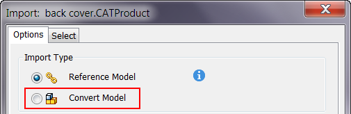

Importing as an AnyCAD Convert Model
You can import the following files as an AnyCAD convert model: CATIA, Solidworks, Solid Edge, Pro-E/Creo, NX, JT, Alias, Rhino, IGES, Parasolid, STEP, Fusion 360, and SAT.
The Convert Model option creates new Inventor files which are not linked to the original. Use this option if you plan modify the model for a new design.
The Convert Model operation does not maintain associativity with the original file. As a result, changes to the original file after the import operation do not affect the imported part or assembly. Likewise, changes to the imported part or assembly do not affect the original file.
When assemblies are imported, Inventor attempts to preserve the assembly and subassembly structure of the original file.
