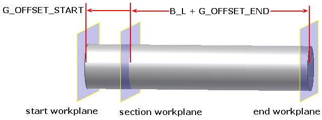

Create Parts - Include Modeling Requirements
- Create two workplanes offset from the XY plane. These workplanes are used for the start and end workplanes.The Start workplane offset value is 0. The End workplane offset value is the base length of the part.
- Create another parameter, give it any name (such as B_L), and set its value to 1 inch or 10 mm (metric standard).
- Define three parameters to dimension distances between these planes:G_L is the base length required to map as a category parameter. Set it as the export parameter. G_OFFSET_START dimensions the distance between Start Plane and Section Plane, and displays end treatment distance in Frame Generator. You can use 0 as the setting during model creation. G_OFFSET_END dimensions the length distance between End Plane and Section Plane minus B_L, and displays end treatment distance in Frame Generator. You can use 0 as the setting during model creation.
-  Extrude the sketch using extents From To.- In the Extrude dialog box, click Profile, and select the sketch on the Section Plane.
- In Extents, select From To. Click the upper selection arrow, and then select the Start Plane. Click the lower selection arrow, and then select the End Plane.
- Click OK.
- Edit the parameters. Start plane - Set the distance to -G_OFFSET_START. End Plane - Set the distance to B_L+G_OFFSET_END.
- Make the part an iPart, if needed, before you start the authoring process. To author an iPart, add the length parameter B_L of the extruded feature to the iPart table.
- Execute the authoring command on the part. On the Parameter Mapping tab, select B_L as the Base Length. Click OK.The part is authored with the required parameters. The Driven Length feature is added, and it is listed in the browser. No dialog box is displayed with information about other modifications.
