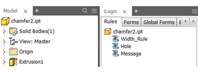

- Each tab can be moved and docked. Below is an example side by side docking.

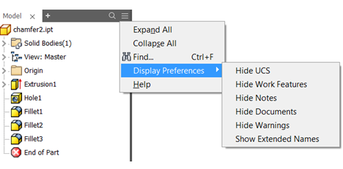

- New Browser menus: Select
to access display options and Help:
