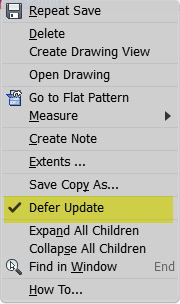

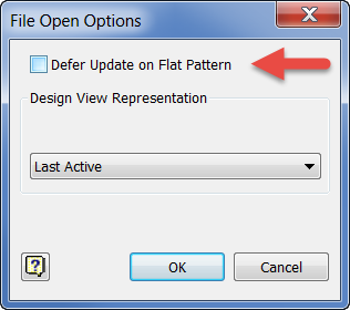

Defer Flat Pattern Update
- The Flat Pattern Compute option is added to the Modeling tab of the Document Settings dialog box.
- Defer Update on Flat Pattern is added to the File Open Options.
- You can also right-click the Flat Pattern on the browser to defer the update.
