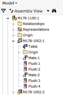

Model Browser Enhancement
The visual display of model browser in all environments now displays lines in the hierarchy to:

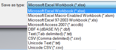

Enhancements to Revision Tables and Parts Lists Exported Excel Formats

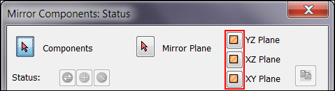

Mirror and Copy Assembly Option to Ground the Resulting Components
The new option Ground New Components in the Mirror Components dialog box/Copy Components dialog box automatically grounds the resulting mirrored or copied components:

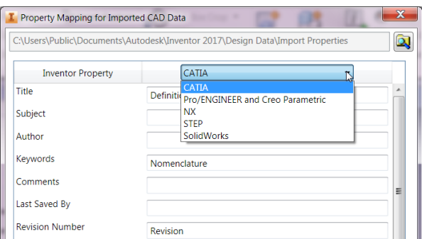

Quickly Customize Properties for Imported CAD Files with the New Property Mapping Tool
Use the new Property Mapping for Imported CAD Data tool to easily map properties from CATIA, Pro/Engineer and Creo parametric, NX, STEP, and Solidworks to standard Inventor properties.
The new Property Mapping tool replaces the manual effort of directly modifying the CATIA, Pro/Engineer and Creo parametric, NX, STEP, and Solidworks XML design data files.

Access the new Property Mapping for Imported CAD Data tool from:
Programs
Autodesk
Inventor 2017
Tools.

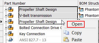

Reference Model Enhancement to the Parts List and Bill of Materials (BOM) (not available in Inventor LT)
You can now open the top-level assembly of an associative reference or virtual part from a Parts List or BOM. Right-click on a parts list or BOM row that contains an associative reference or virtual part and select Open. The top-level assembly containing the reference to the associative AnyCAD reference or virtual part opens.

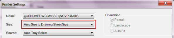

Save Time Printing Multiple Drawings with Auto-Size to Drawing Sheet Size
The new Auto Size to Drawing Sheet Size option in Task Scheduler's Printer Setting dialog box allows you to batch print multiple drawing (.idw/.dwg) files set to different sheet sizes and orientation. This new option automatically chooses the appropriate paper size and orientation as specified in the drawing sheet setting.
This setting is only available when the files in the Task Scheduler Print Files dialog box are drawing (.idw/.dwg) files.
---------------Task Summary---------------- This task has processed 1 file(s) out of which 1 file(s) failed. Errors encountered as follows: C:\Users\itools\Desktop\New folder\80-110.dwg--Printer does not support designated paper size, unable to process valid output on accurate sheet size. ------------------------------------------- |

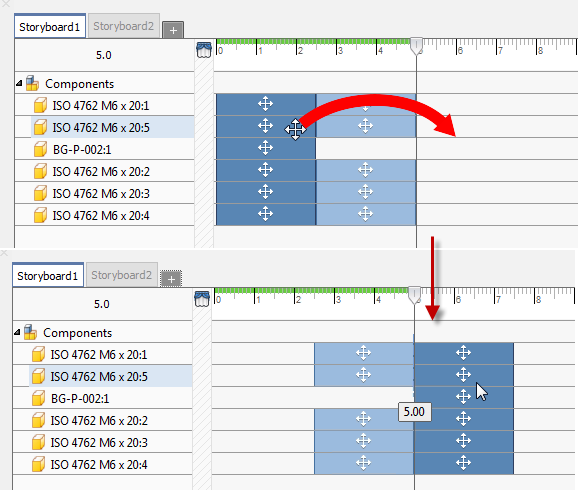

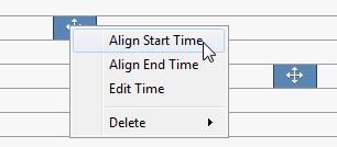

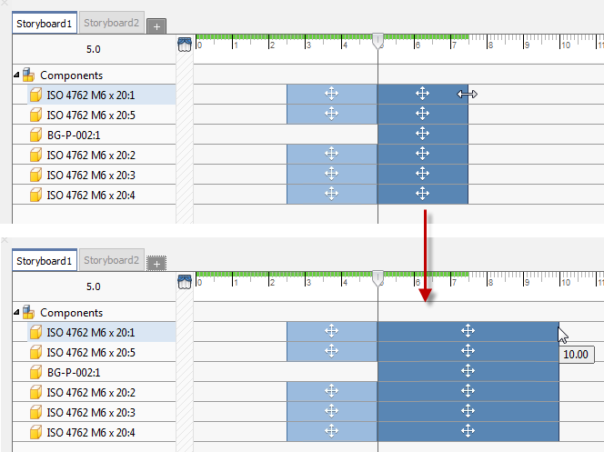

Multiple Action Editing
You can now edit multiple actions in various ways.
Move: Select multiple actions using Ctrl+click and then drag the selected actions to a different location on the timeline. You can drag to a position before or after other tweaks. Moving actions can be done with any selection of actions. When dragging actions with different start/end times, the selection set maintains the relationships.

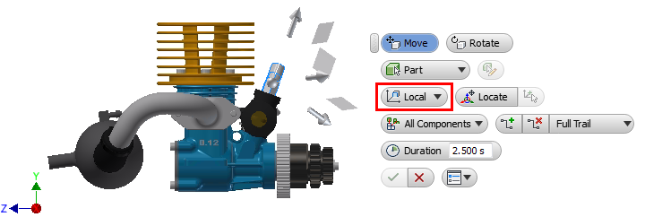

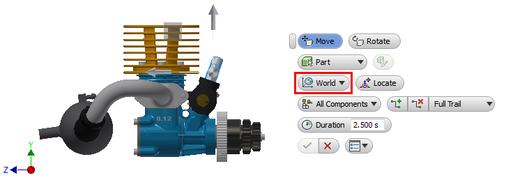

Local/World Direction
You can now specify tweak direction using the local (component) coordinate system or the world (presentation) coordinate system in the mini-toolbar. For multi-selection sets the local coordinate system aligns with the first object selected.

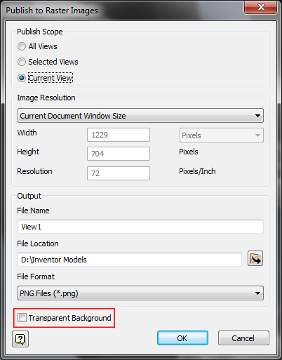

Publish Images with a Transparent Background
Select a Snapshot View to publish as an image. Click Raster
. At the bottom of the dialog box, check the box for Transparent Background.
Publish Raster
When publishing an image, you can now select from a list of provided resolutions or specify the image resolution.

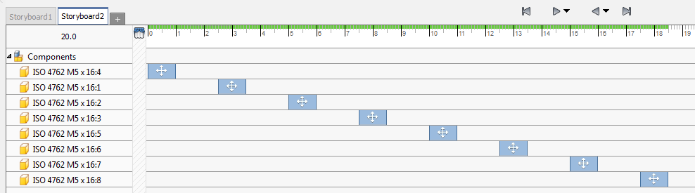

Expand/Collapse All Children in the Storyboard Panel
Use Expand or Collapse
