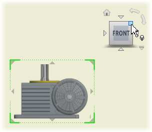

When you create a base view, View Cube is displayed next to the upper right corner of the base view. Click a View Cube face, edge, or corner, or click the rotation manipulators to set the desired orientation of the model.
Note: The View Cube replaces the Orientation options from the Drawing View dialog box.

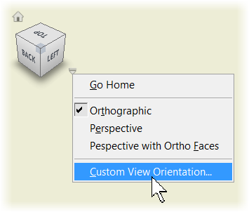

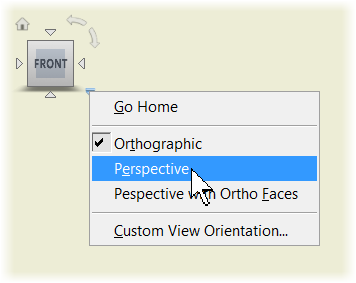

Custom View Orientation
Right-click the View Cube, and click Custom View Orientation to enter the Custom View environment. Then specify the orientation of the custom view.
Orthographic and Perspective Projection
By default, Orthographic projection is used to create drawing views. To use Perspective projection, when you create a base view or edit a base view or independent projected view, right-click the view cube, and click Perspective.

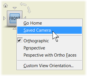

Saved Camera for Presentation Views
For drawing views based on a presentation view of the model, you can access and apply camera settings saved in the presentation file (.ipn). Right-click the View Cube, and click Saved Camera.
Model orientation in the drawing view changes to match orientation saved in the presentation view.
Temporary Base View Position
When you start the Base View command and specify the model, the base view is placed in a temporary position on the drawing sheet. Hover over the base view to display the Move manipulator. Then drag the base view to the desired place.

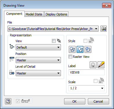

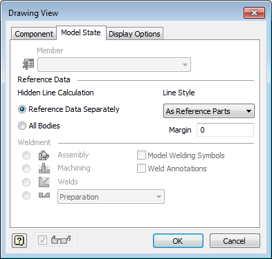

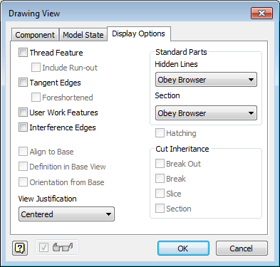

Revised Drawing View Dialog Box
The Drawing View dialog box is streamlined to support new workflows with direct interaction in the graphic window.
Size of the dialog box is reduced:
Some dialog box options are moved, changed, or removed:
Component tab
Display Options tab
Model State tab
