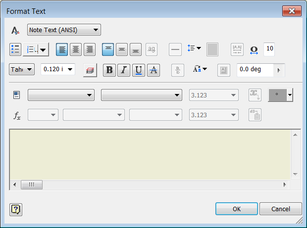

Redesigned Format Text Dialog Box
The Format Text dialog box is simplified and refined to be clear and easy to use. Size of the dialog box is reduced to provide more space for editing in the graphic window.
Bullets and Numbering in Text
You can create bulleted or numbered lists in the Format Text dialog box. One bulleting style and several numbering styles are available.
Text Case Options
In the Format Text dialog box, select a string, and select a Text Case option to convert the string to UPPERCASE, lowercase, or Title Case.

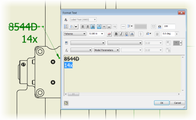

Strikethrough Text
In the Format Text dialog box, click the Strikethrough button to apply strikethrough formatting for a string.

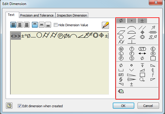

Enhanced Symbols List
New graphical symbols are added in the Symbols list in the Format Text dialog box.
Graphical symbols are organized in the following groups: Most Common, Geometric Characteristic, Material Removal Modifier, Additional Symbols, General, and Character Map.
Note: The active Feature Control Frame style controls the list of symbols available in the Format Text dialog box.
Edit Dimension Dialog Box
The symbol drop-down list has been removed and replaced by the graphic symbols as first-level options.
Text Preview in the Graphic Window
Text in a drawing file is dynamically previewed in the graphic window when you create or edit it. You can refine the appearance of text before you close the Format Text dialog box.
