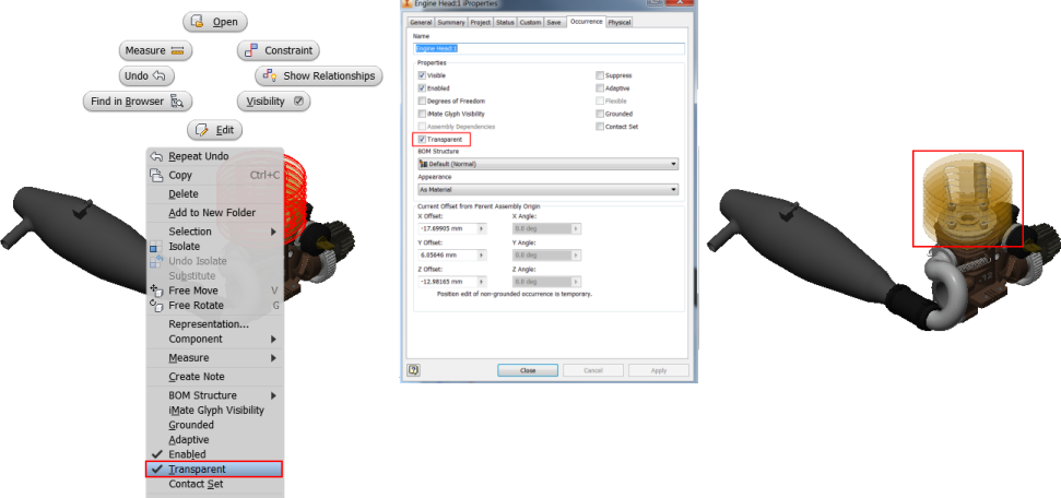

Make Components Transparent
You can now toggle the transparency of a component in an assembly without applying an Appearance override.
Select one or more components in the graphics window or browser and then:
  1. Right-click and select Transparent from the context menu.
  2. Select iProperties from the context menu to open the dialog box. Click the Occurrence tab, and then select the Transparent check box.

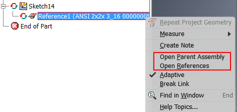

Open Files Directly from the Browser Node
A new right-click context menu option is available in the assembly browser Modeling View that lets you open reference files directly from your browser.
In a part file, right-click the Reference node in the browser and select Open Parent Assembly from the context menu to examine cross-part references in the assembly file the reference was created in. Select Open References to open the part the reference was created from.
In addition to References in a sketch, the same functionality is available for adaptive work features for copied objects.
