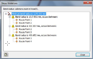

New Show Violations Dialog Box Provides Visual Feedback for Flexible Hose Violations
The message box that displays when you check a problematic bend radius has been replaced with the new Show Violations dialog box. The new Show Violations dialog box displays a tree view of spline segments where bend radius violations occur. Selecting a node in the dialog box highlights the corresponding segment in the graphics window.

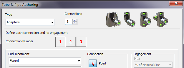

- Tube and Pipe Authoring:
Now resizable, the width of the dialog box also increases when over seven connection numbers are added.

Tube and Pipe End Treatment Publishing Enhancement
While publishing Tube and Pipe content in the Tube and Pipe Authoring dialog box, the last used End Treatment setting for connections auto populates when you add connections.
